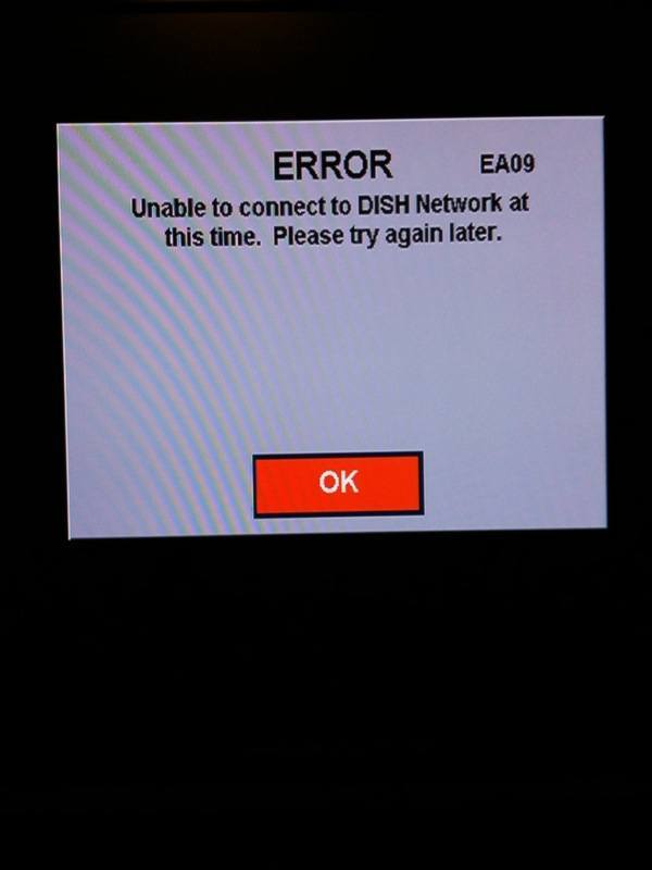

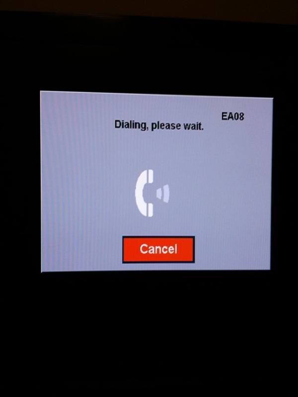

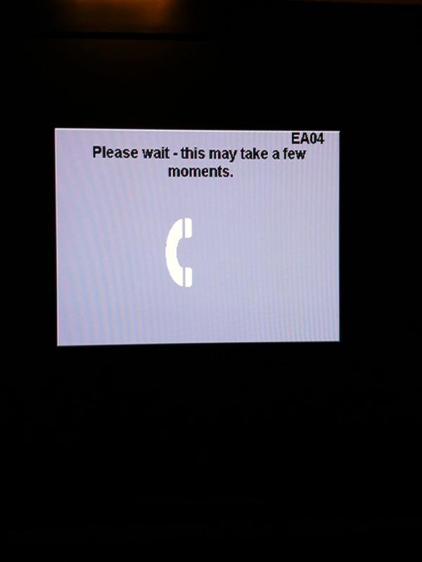

What is up with the Customer Support app on Dish Home Interactive? It will not connect to Dish Network. I have 4 receivers 2(Vip622's and 2(Vip612's)) and they are all hooked to the phone line and Ethernet. I do not have DSL(Wireless interet) and the receivers are hooked directly to the router. Every time I try to make a payment or view the bill on my TV it does not connect to Dish Network. I have to unhook the Ethernet cable in order to get it to work. If I should not have to keep unhooking the Ethernet cable in order to get the app to work. The receviers dial out and show it is trying to connect to Dish Network but it does not connect. To use this as an example- The receiver Diales out and Dish Network pickes up but does not say any thing and the receiver hangs up. I have attached to this post the screen shots I keep getting when I go to this app with the ethernet cable hooked up. I have e-mailed Dish Tech support and they are blaiming something on my end. I replyed back and told them that my cables and every thing is working just fine. I tested all the cables and they are working great. So it would have to be some thing on Dish Network's end but they will not abmit it.

And all of my receivers are hooked to the internet for Dish-Online and hooked to a phone line to view Cellared and to use the Customer Support app on Dish Home Interactive. When I go to the Customer Support app on Dish Home Interactive and go to view my bill it will not connect to Dish Network. I first get a message saying Dialing, Please Wait(EA08) then I get a message saying "Please Wait- This may take a few moments(EA04). then a few moments later I get a message saying ERROR, Unable to connect to DISH Network at this time. Please try again later(EA09).
I have all my receivers connected to the phone line and Ethernet cable coming from my router. Now in order to get this app to work I have to unplug the Ethernet cable and keep the phone line hooked up. When I unplug the Ethernet cable then the Dish-Online app will not work and I cannot manage my DVR's VIA the Dish Network app on the iPhone. So I have to keep both cables hooked up. I have tested all of my phone lines and Ethernet cables going to the receivers and they work well. So that is not the issue on getting the Customer Support app to connect to Dish Network. It is something on Dish Networks end.

Like I said in my post is that I have tested my phone line going to all of my receivers and they work just fine. The Problem with the EA09 on the Customer Support app it on Dish Networks end. Like I also said I have to unplug the Ethernet cable in order to get the Customer Support App to work. I find it strange that it happens on all of my receivers. My phone lines and Ethernet cables are working just fine I have tested both of them. I find it strange that it happens on all 4 of my receivers (2 VIP622's and 2 VIP612's) I can send and receive faxes on my fax machine just fine so and my Fax Machine is hooked to the same phone line as my receivers and my fax machine is not interfering with my phone line in any way. So you can not say it is my fax machine or phone line. I should not have to unplug my Ethernet cable to get the Customer Support App to work properly. If I unhook my Ethernet cable I can not manage my DVR shows over the INTERNET nor does the Dish Online app work with out the Ethernet cable. So Dish needs to not blame any thing on my end like Dish Network always does. I have tested every thing and it is more than likely on the Dish Network end. Every thing on my end is set up and working correctly. Just like all of the problems I mentioned on my post is some thing on Dish Network's end not mine. So do not blame it on my end and FIX the problems.

So it is not just my 4 receivers then if others are experiencing the same thing. Why does Dish insist on blaming the problem on my end and my equipment? It is clear that it is on Dish Neworks end. Dish Network need to work on the Dish Home Interactive apps any ways. It could be inproved.
I just tried 5 times and only succeeded in locking up my 722. :( It seems to be calling (866) 767-2759. The remote modem answers and starts up the handshake, but like the OP it never connects.
