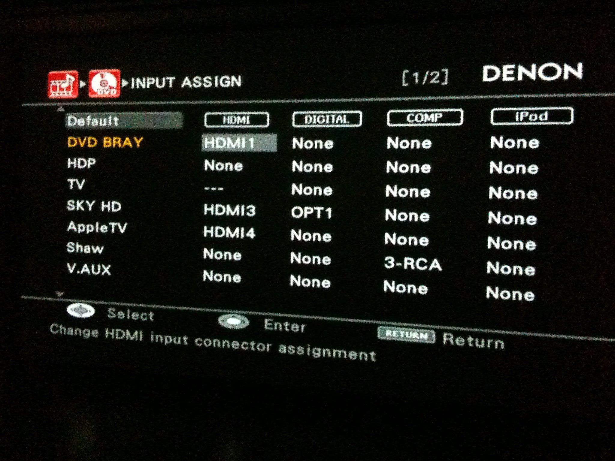

Thanks for the info, unfortunately I do not know how to assign the component inputs. In the assignment screen it gives the option of HDMI, which I have in none... and COMP which gives option of RCA1, 2 or 3. I have tried all rca options but no signal.

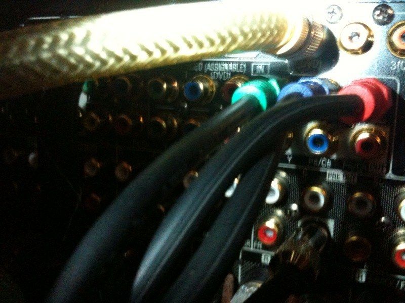

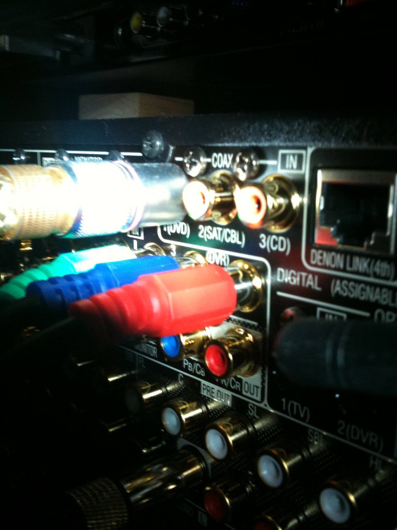

OK do this. Take a picture of where you have the component cable plugged in to the back of the Denon. Then take a picture of the assign screen. And we can walk you through it.

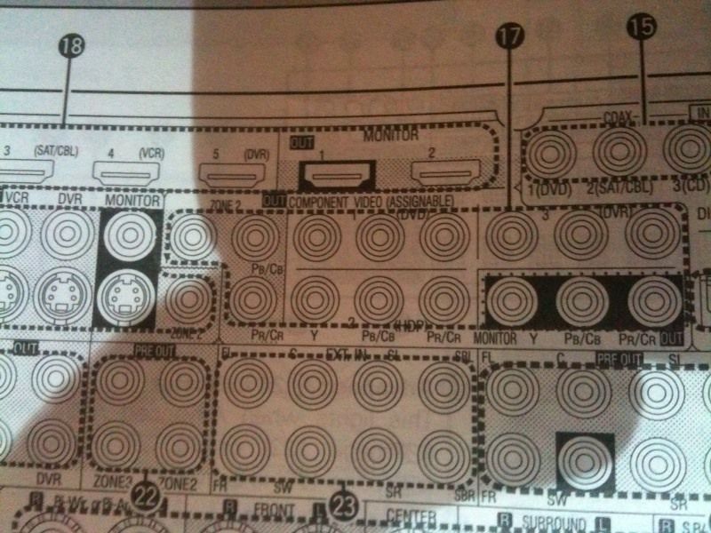

I apologize for the delay, here are the photos. I included the part of the diagram that the cables are hooked up to as the photo is hard to see.
Thanks for your help,iIf you need more info please let me know.

From the pic of the assign screen, I'd say to use the right arrow key, and move the highlight over two places (under Comp), and press the Enter button. That should assign it to COMP (component).
