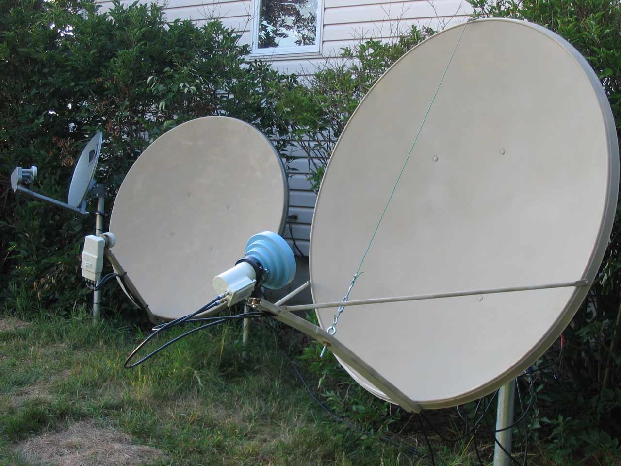

[edit] Note my Fortec 1.2M dish in the pic. Turns out that I had to put a support cable on the support arm and draw the lnbf into the optimum position. The side arms simply didn't position it very well. Hopefully , your results will be better.
