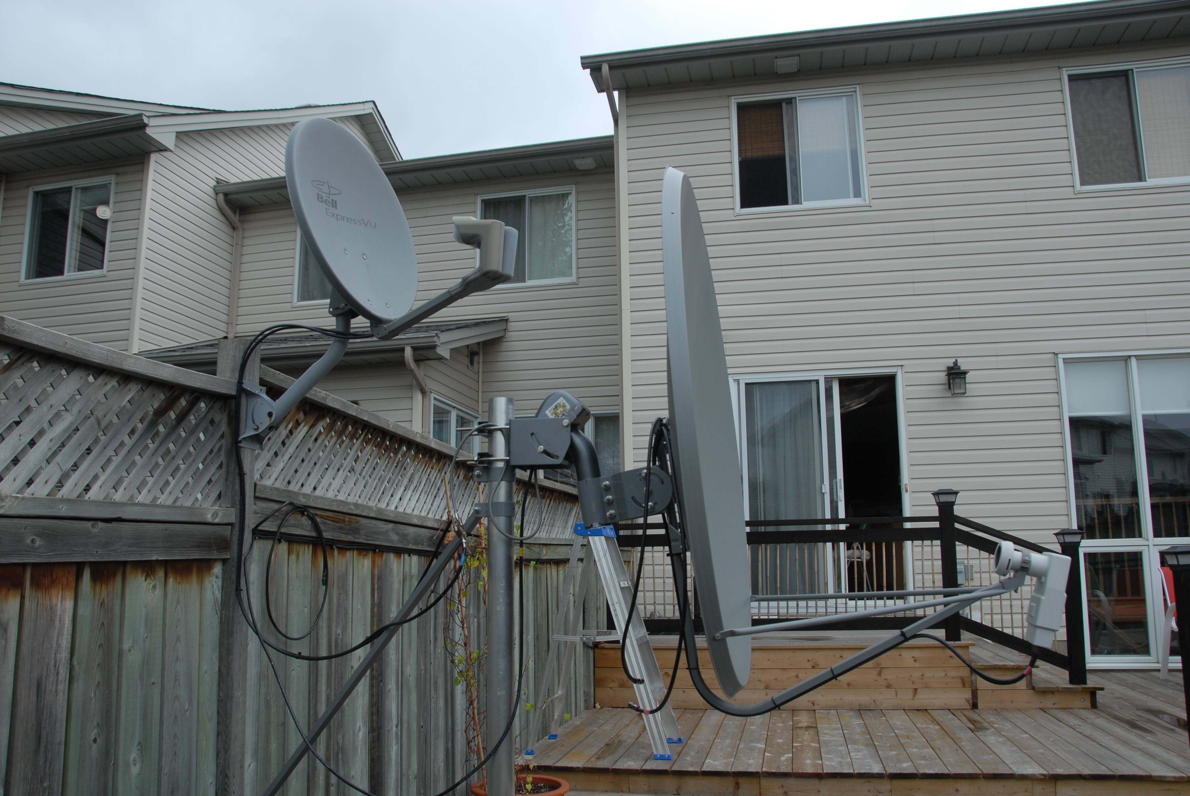

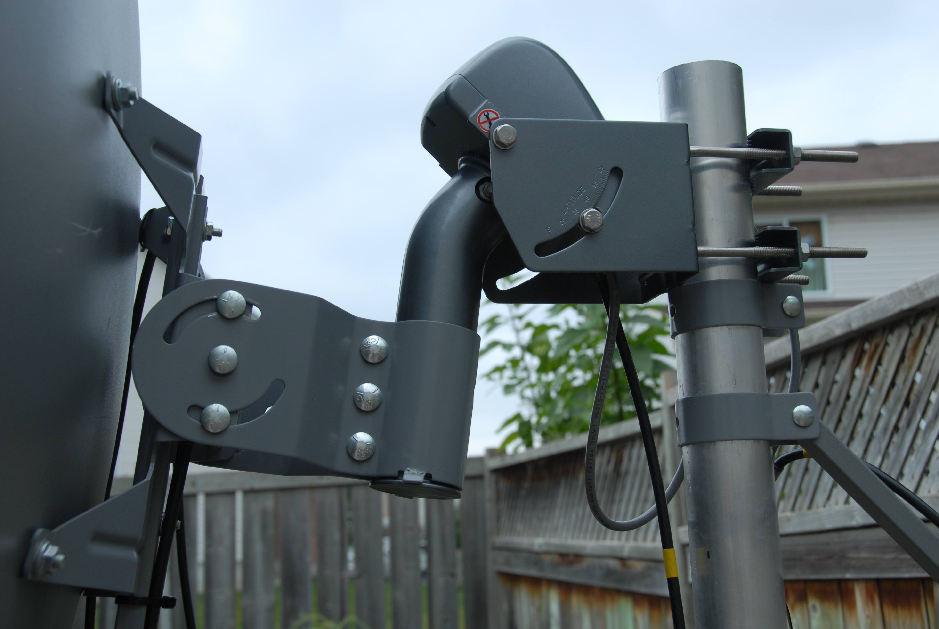

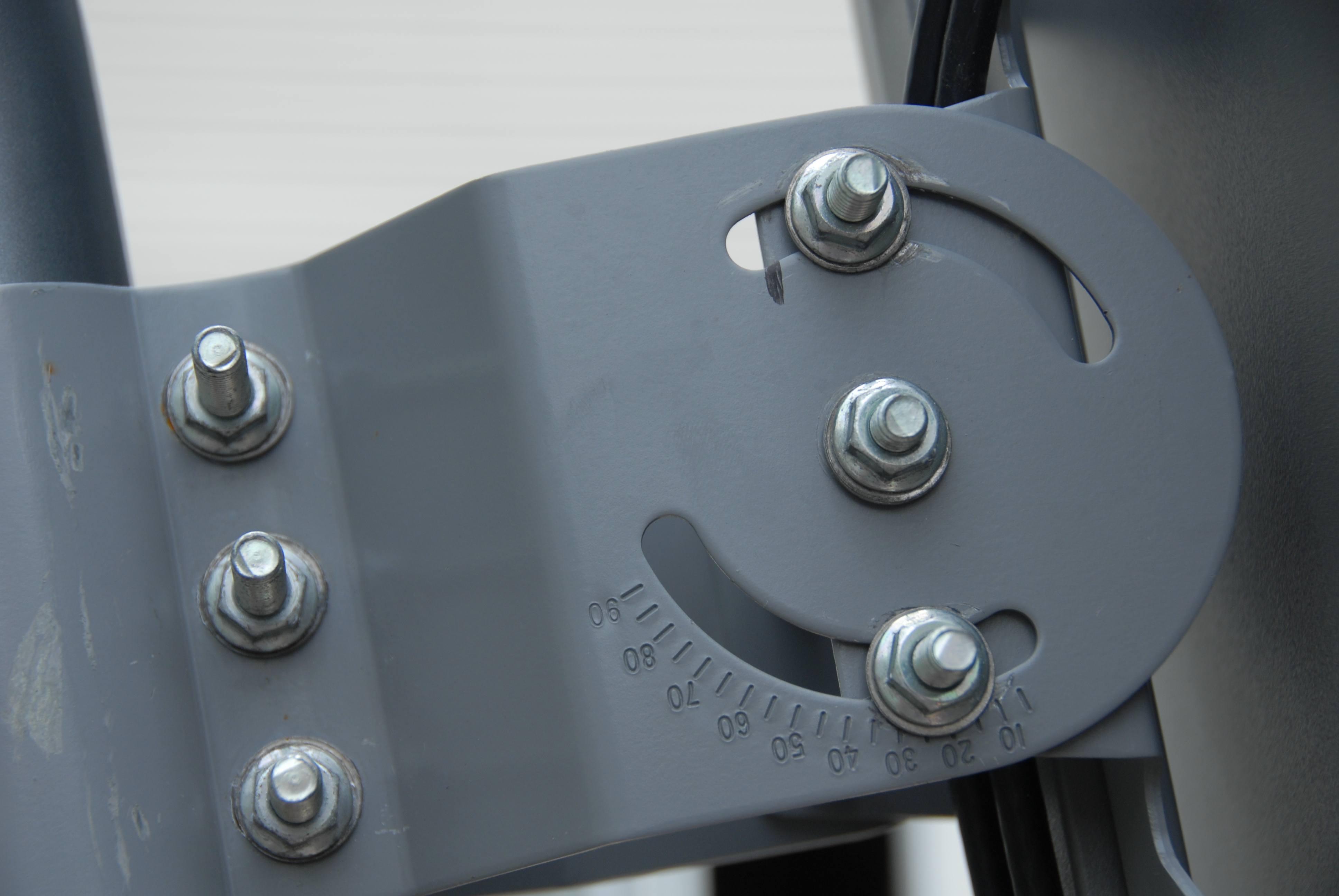

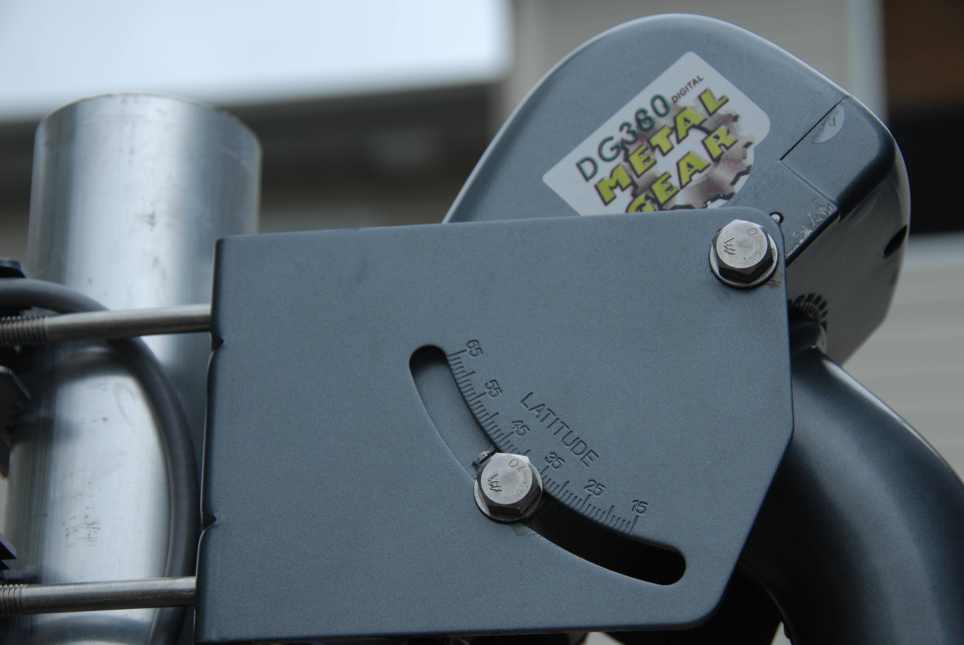

UPDATE....
I've talked to representative @ Sadoun and was advise to fill up RMA form which I did.

Hoped we could see something you might have overlooked.
If so, I don't see it. Maybe others will. Seems good to me. - :up
