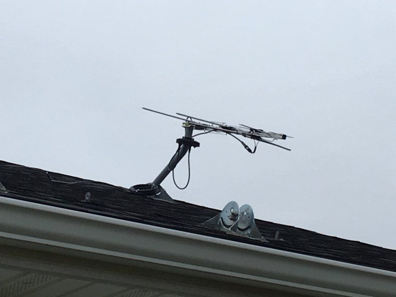

Mine is tilted downward. I spent a lot of time up on the roof adjusting the antenna, cell phone in hand, watching my signal quality meters using the Signal GH iphone app, and to my surprise, the highest gain for all my stations was achieved by tilting my antenna downward. It remains there today.
