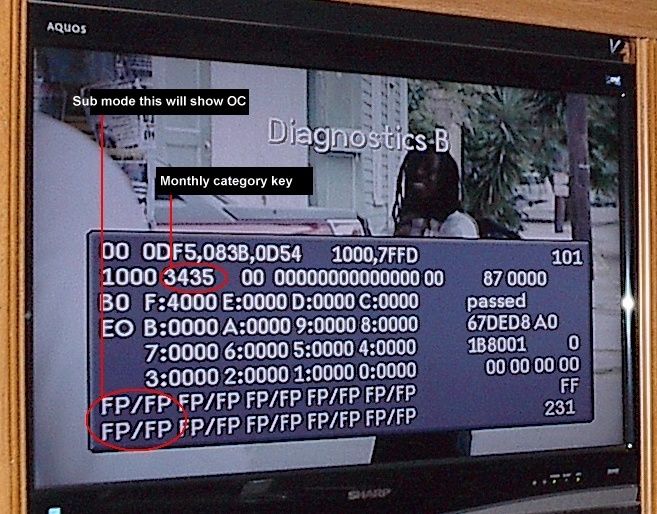

Did you convert and sub to 4160? If not maybe CK 3535 on 4096 went OC. I can't tell since I'm on 4160 I have CK 3635. Everything fine here.
I have been posting on my site for a while that the 3535 category key will expire and for those with it to convert or loose any free programming. You can see if it went OC by going to options 6,0,5 Diagnostics B. If it shows OC there is nothing you can do but convert if you want subscription programming.

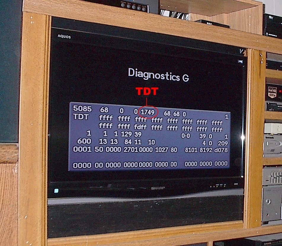

You can only have 1920 TDT entries then the memory is full and weird things happen. My TDT is 1748. Download the Diagnostics Manual on my site, it explains all about the diagnostic screens and what they mean.
Whats your TDT? If it's 1920 it will cause satellites to become lost when new maps are added. G0 contains channels maps for the conversion.
TDT stands for Transponder Data Table. I find it easier to remember when the words can be associated too. Like, for instance, Satellite Receivers Limited (SRL). ;)
My EMM is still 4106, because I had to use that reset password thing to get programming. Nothing else worked, even with Skyvision's help (before the 13th, havent tried since) I was watching the satellites i usually watch plus the subscription on W5. it just disappeared yesterday. I don't see OCC on diagnostics B anywhere.. I do look at your site but didn't notice CK anything, I dont even know what a CK key is.

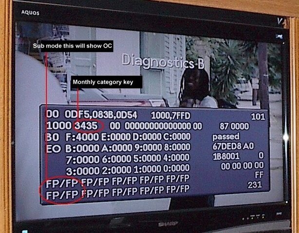

Could you tell me which lines you're referring to on the diagnostics B screen ? the reference names in the manual don't seem to correlate with my newbie brain translation of satellite terms I see on here
Hope this clears it up.
Here is the information Genna (see attached) It shows where to look for OC (Old Category), The monthly category key (Current is 3635) and TDT this is in Diag G
Your EMM has to be either 4096 (Motorola) or 4160 (Comcast HITS)
Thanks for posting those images, saved the links to them in case some other hapless 4dtv victim needs them :) My EMM is 4160, my "CK" says 3435 the sub mode is US my "TDT" is 1708.
