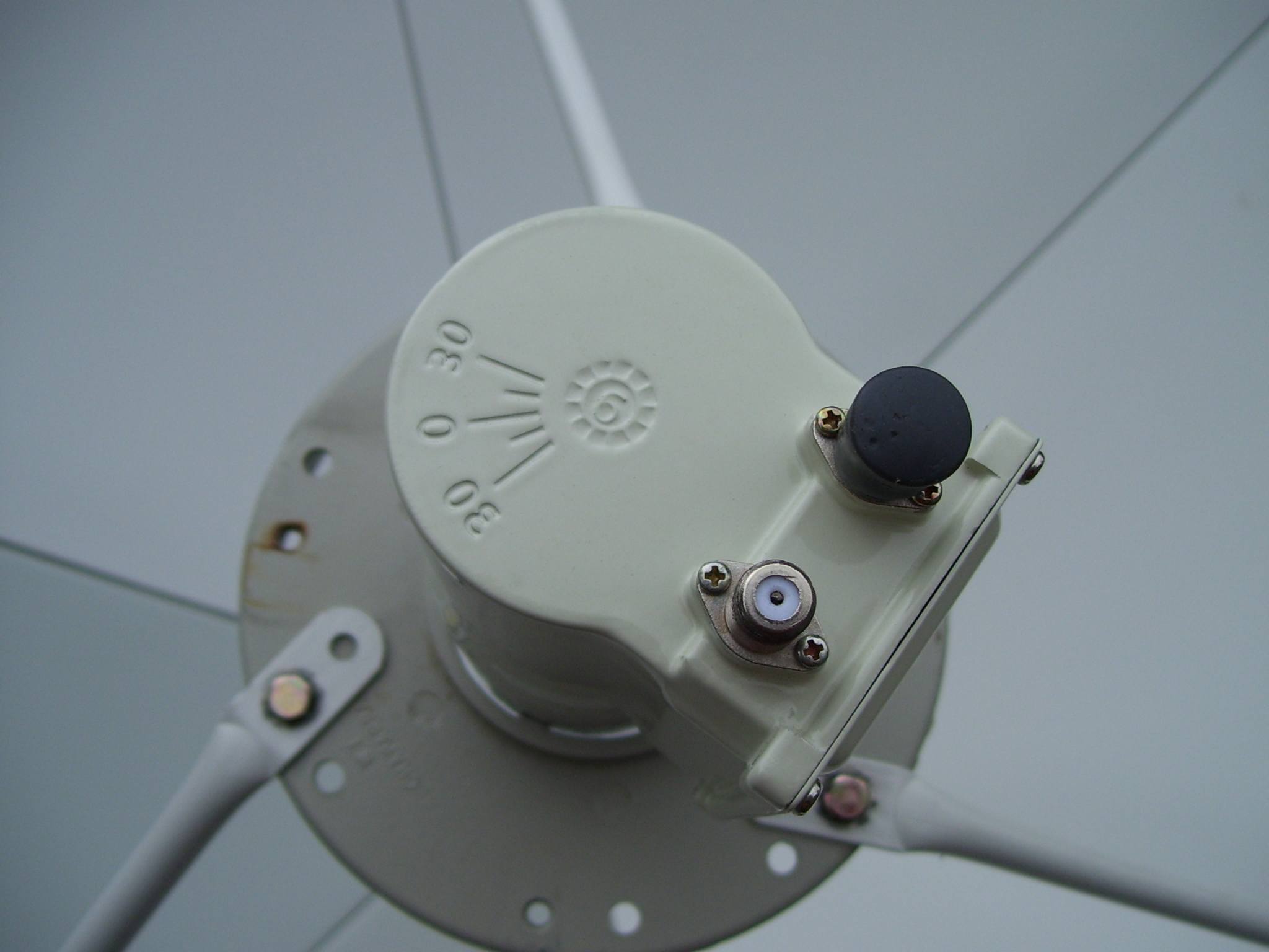

actually on those LNB's the skew is off by 90 degrees. So you have to "0" it at 3:00 or 9:00 (think clock)
Ok, I've rotated the LNBF before but not sure about the skew. I seen the 30 - 0 - 30 marks on the top, which way does the LNBF face when looking toward the antenna? I didn't get any instructions or diagrams with the LNBF.

The a zero on that lnbf should be at the 3 o'clock or 9 o'clock position for correct V/H. If it's at 12 or 6, your polarity will be opposite of actual. 83W-Look for PCN, 3804 V 4167 (it's the only one there)
if its 0 skew it should look like this
Thankyou Iceberg for the photo. Mine was turned around. I changed it to the nine o-clock position. I'm still only getting just high signal but no quality on the receiver.
