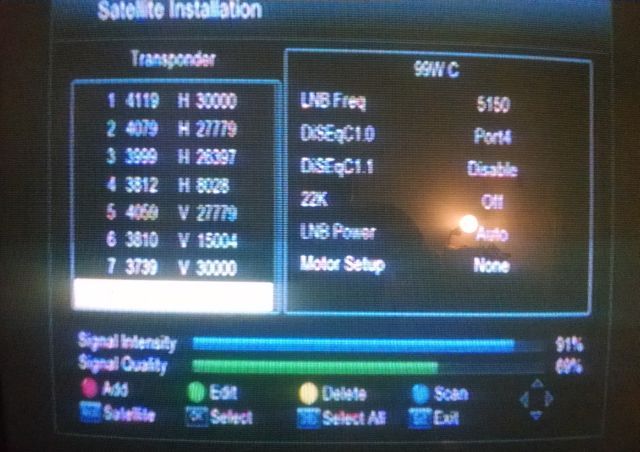

. I still haven't been able to locate a signal meter that locates satellite signals before a scan is done. I tried to use the signal meter in the satellite setup menu but it did not display a signal when I was looking for RETRO TV and some others.
You have to first manually program in at least one valid transponder.
In the satellite installation menu select the satellite, then click the recall button,
Add a transponder with the red button.
Next highlight the desired transponder, meter will show S and Q of highlighted transponder:
3720 H 8703 selected (transponder #8), its hard to see. (KRBK Mux on 99W C)
After you fiddle with the dish and tune the transponder, then hit recall again and blindscan the satellite.
Thanks fred555, did as you suggested and it worked perfectly.
