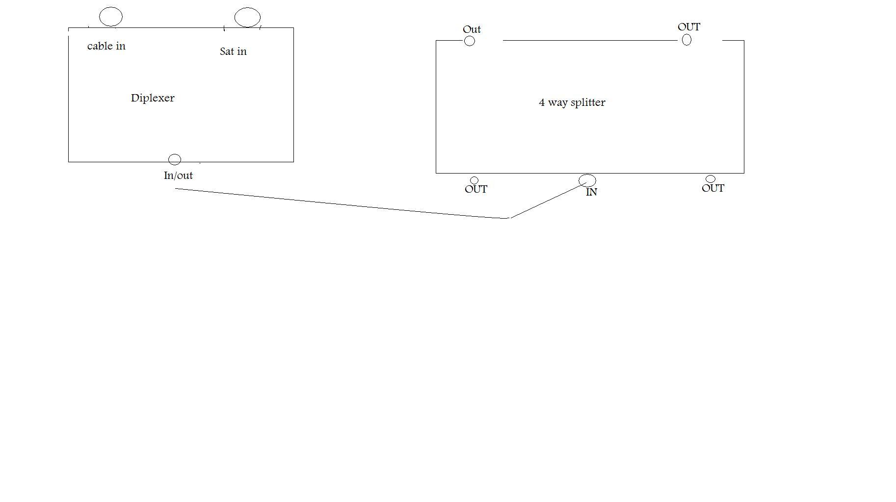

Hello,
I like to know if i can use the following setup. I have Splitter setup which I have incoming cable connected to but recently I installed Sat Galaxy 25 FTA and like to get my cable/internet and sat use the same cable coming into the house. Is this possible? I know two diplexer are needed one outside cable/sat coming in other near the Tv/receiver. I have included a diagram. I am trying to avoid another line through the rented house.
Thank You

As long as the 4-way goes up to at least 1450MHz and passes DC, it will work fine. Realize, though, that you can only have one receiver connected at any given time. Also, if you have cable (includes internet), both the splitter and diplexer need to go down to 5MHz.
Another option would be to insert 2 diplexers at the splitter and route the satellite around the splitter.
