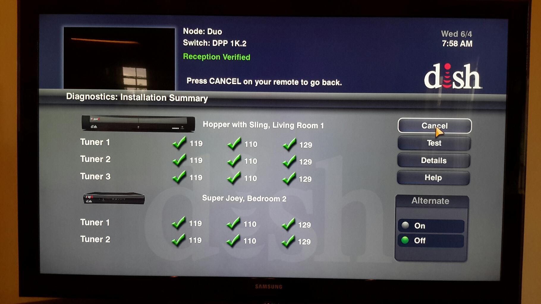

I just connected my Duo node back up. I have the HWS on a host and SJ on the other host. The 2 client ports I have terminated. I plugged in the hopper, ran a check swith. I then plugged in the SJ. It took a while to get going. I ran another check switch and all 5 turners are going. I get good moca, in the green. Did your SJ ever sync to the hopper? Were you could see the guide a select a channel from the SJ? It may need to be connected correctly the first time. I had tried this a few months back just to see if it would work. I did connect it correctly to begin with and everything worked to start with, before i tried the DUO node. Here is a picture of the check switch screen. I am switching it back to the solo node now, just to be safe because of the voltage concern.

That's correct, the point dish /check switch is not available on the SJ. I ran the check switch from the hopper twice. Once when the hopper was up and then again after the SJ came up.
