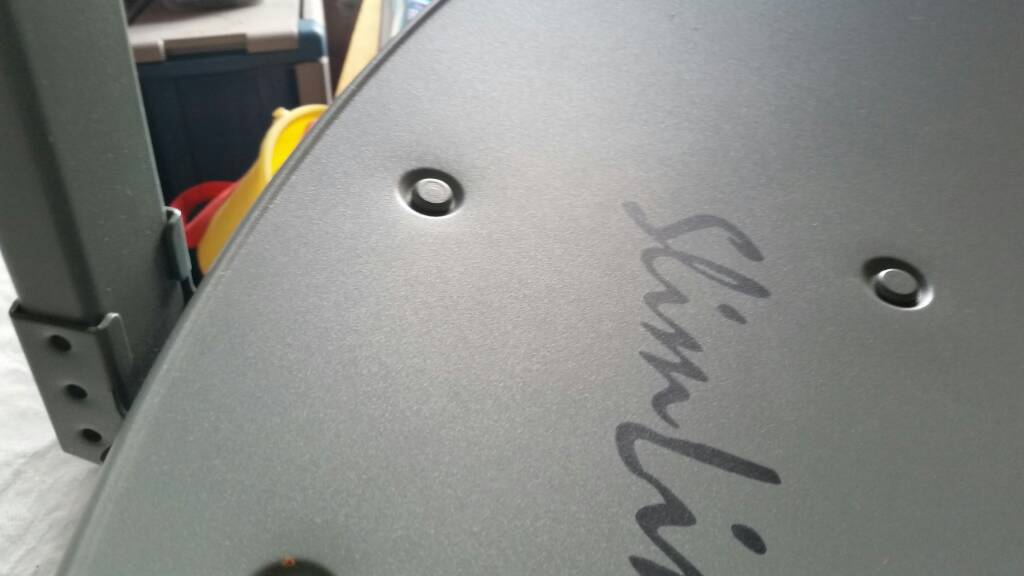

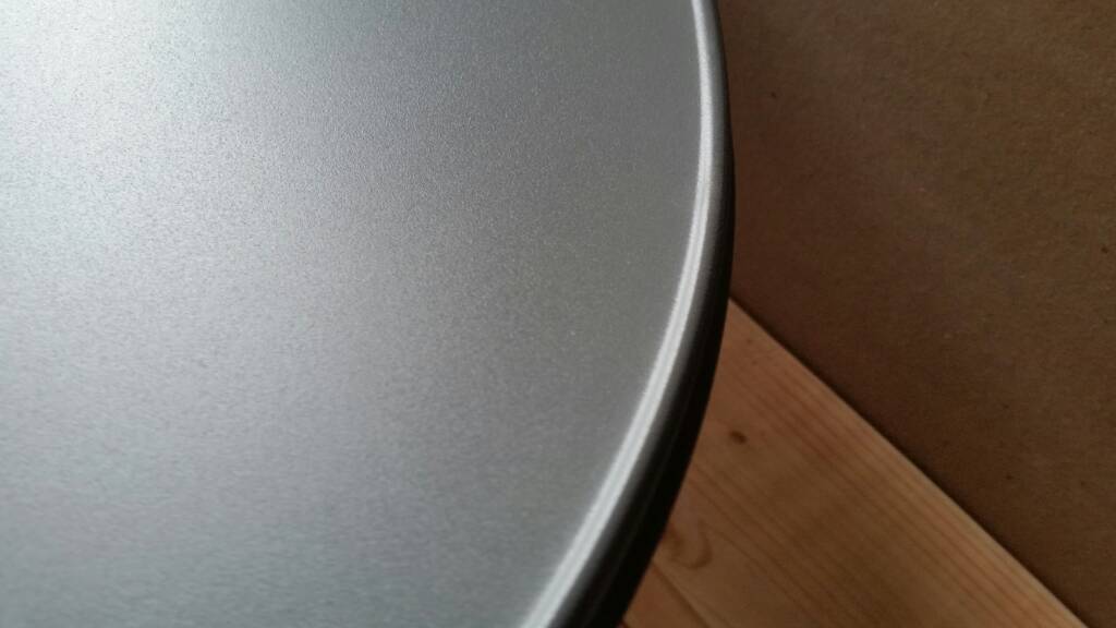

I have to ask, By any chance does your Slimline Dish have a raised edge on it?
Like this...
