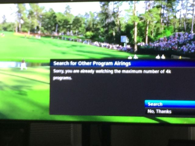

I had a problem trying to watch when I got home got the following work and got this error message that all 4K streams were in use.
I only have a HR54 and C61K and the C61K was on ESPN.View attachment 115654
I hate to reboot the HR54 in order to watch it. And when I finally tuned in it was over for the day.
I have had that problem if I leave the C61K tuned to a 4K channel and turn it off. I have been tuning to a HD channel before I turn it off and have not had it happen again.
I had no problem recording 106 either day so far even with the C61K left tuned to 106. I could see a problem if the C61K was left tuned to another 4K channel such as 104 or 9800 since the HR54 can only stream 1 4K channel at a time.
