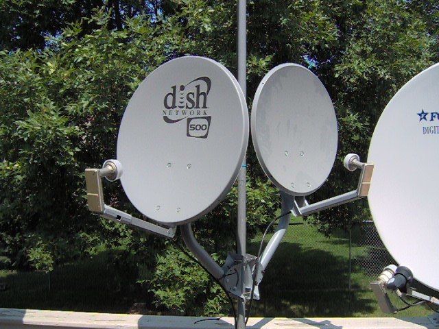

What is this, and is there a picture of it somewhere?
I have an unused D500 that I'm considering putting up for 129. I don't need both lnbs on it, just the one for 129.
here is what a D500 looks like with an I adapter. This dish on the left is aimed at 110. The dish on the right is 61.5 and 119 is over on the big 36" whit dish in the corner :D

If you are using dish 500 to get a better signal on 129, do not use the Y bracket. There is a significant signal loss if the dish is setup is to hit more than one sat. In my experiemce the gain is minimal if you use the bracket and just aim for one bird. The 24" dish aimed properly at 129 should give you significant gain in signal strength over a dish 500 with a dual lnb bracket, but I am not sure that is it enough. A 30" dish in NW US may be a better option. A 39 inch Channel Master dish in mid Alberta is still not enough but the signal drop is not overly long and appears worst at about 9 - 11 at night.
