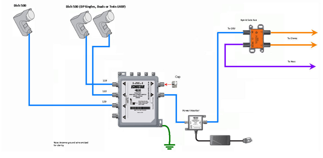

Can someone confirm this front end configuration for a Hopper3?
DPP twin feeding 2 lines to DPH42 for 110 and 119, and a dp single feeding feeding 1 line for sat 129 off a second dish. I haven't seen any documentation that the twin will work.
P.S. I can't use a 1000 dish with hybrid lnb
Yes, that will absolutely work.
Run ports 1 and 2 out of the Twin to ports 1 and 2 Inputs on the Switch and the Wing Dish to Port 3 Input
