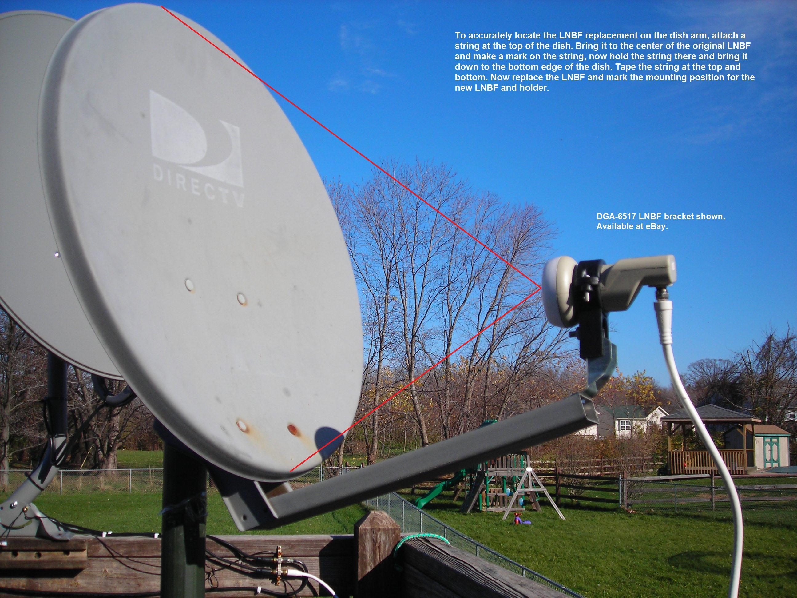

To be fair and balanced to the subject, some people hear have pretty good luck with alot of tech savy and effort. Some TP's on 97W are good with a linear lnbf. Some PBS. But rainfade will wash them out.
I tried without much success to use a Dish 500 measuring 22 x 24 inches with a Linear LNBF attached for true FTA signals. With a good LNBF, a strong satellite signal painstakingly peaked, short run of RG-6, and no switches or couplers to weaken signal, I can get a few strong transponders on 97w and a few other sats near my true south. If a heavy cloud comes between the dish and satellite, signal is lost.
In my experience you need a 31 inch / 76cm or larger dish for a reliable all-weather signal.
