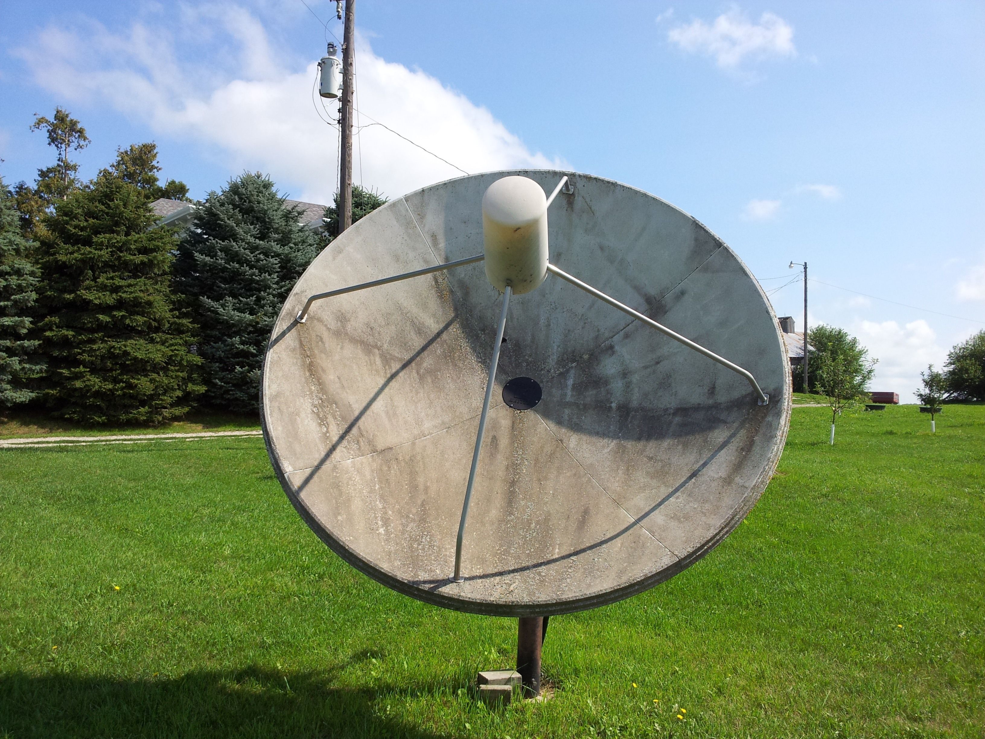

1) $50 for a self removal from a back yard with probably poor vehicle access: 8 Foot Diameter Fiberglass Satellite Dish This dish is one piece and will need the trailer. and some help to pack it to the truck. It's one hr away.

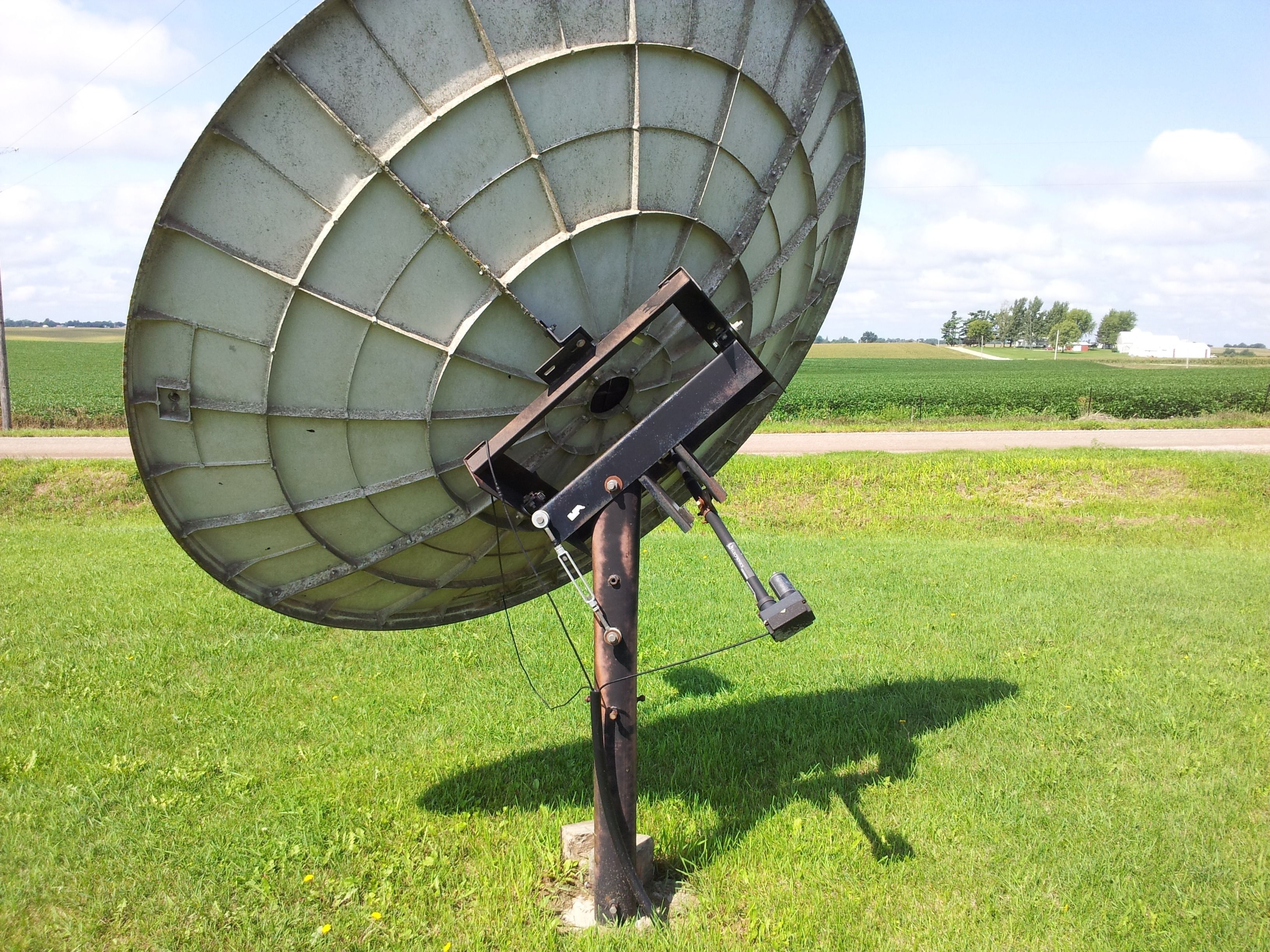

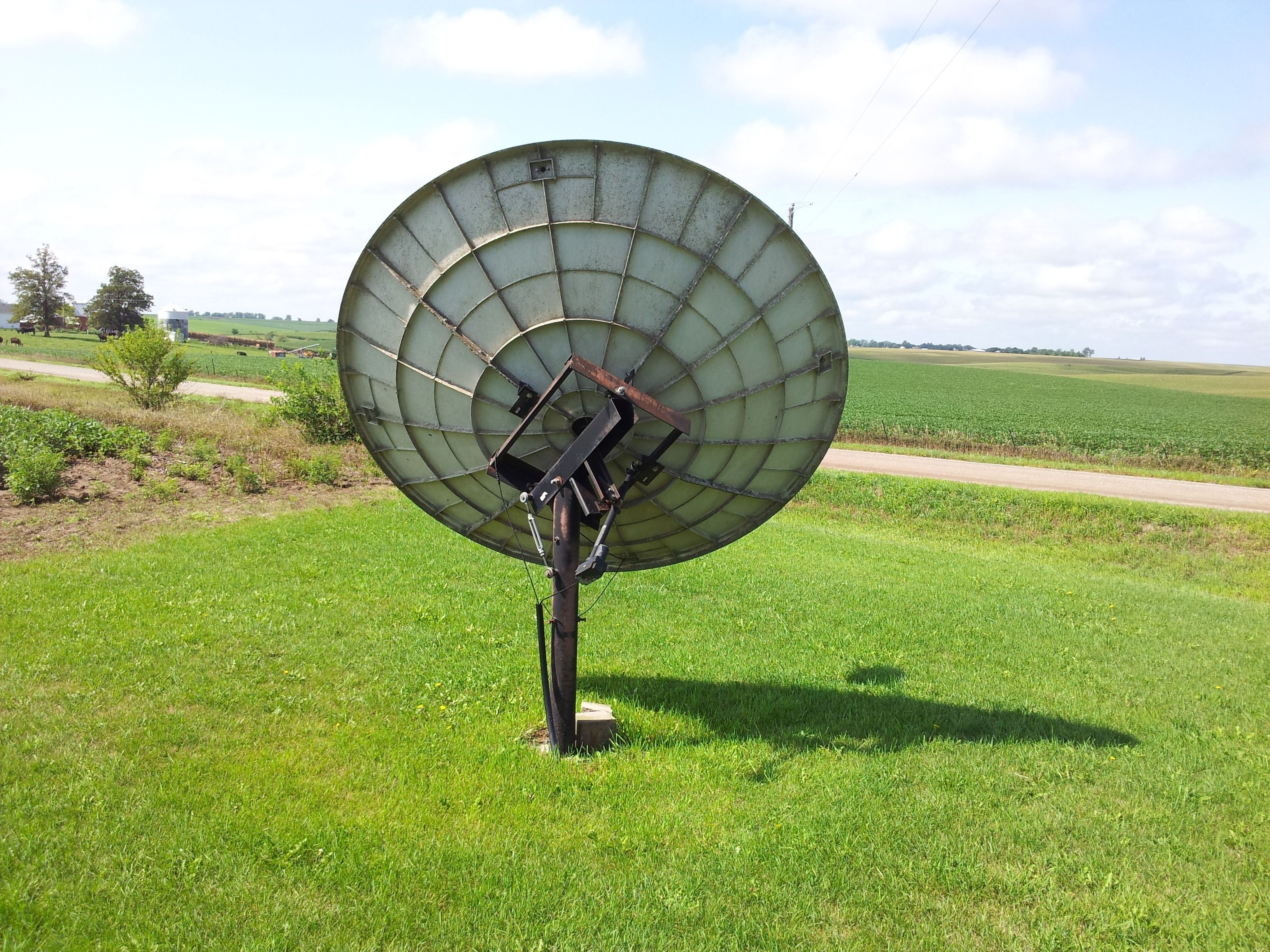

2) Big Satellite Dish/ for removal See pics attached. I asked for pictures and size, she said "Channel Master 16" in diameter". I'm taking the 16" with a grain of salt. ;) This one could be dismantled and hauled in a truck bed. It should be able to be broke down into the panels and mount and pole for easy removal. And I can drive right up to it! It's about 3-1/2 hrs away.

Any thoughts on the first two? Can anyone identify them and give advise on the relative desirability? I'm leaning towards #2 because of the relative ease of removal and portability. But I'd like to hear any sage advice from the "been there, done that" guys. #1 looks like it has a substantially weaker mount design than #2, but that's just from the images.

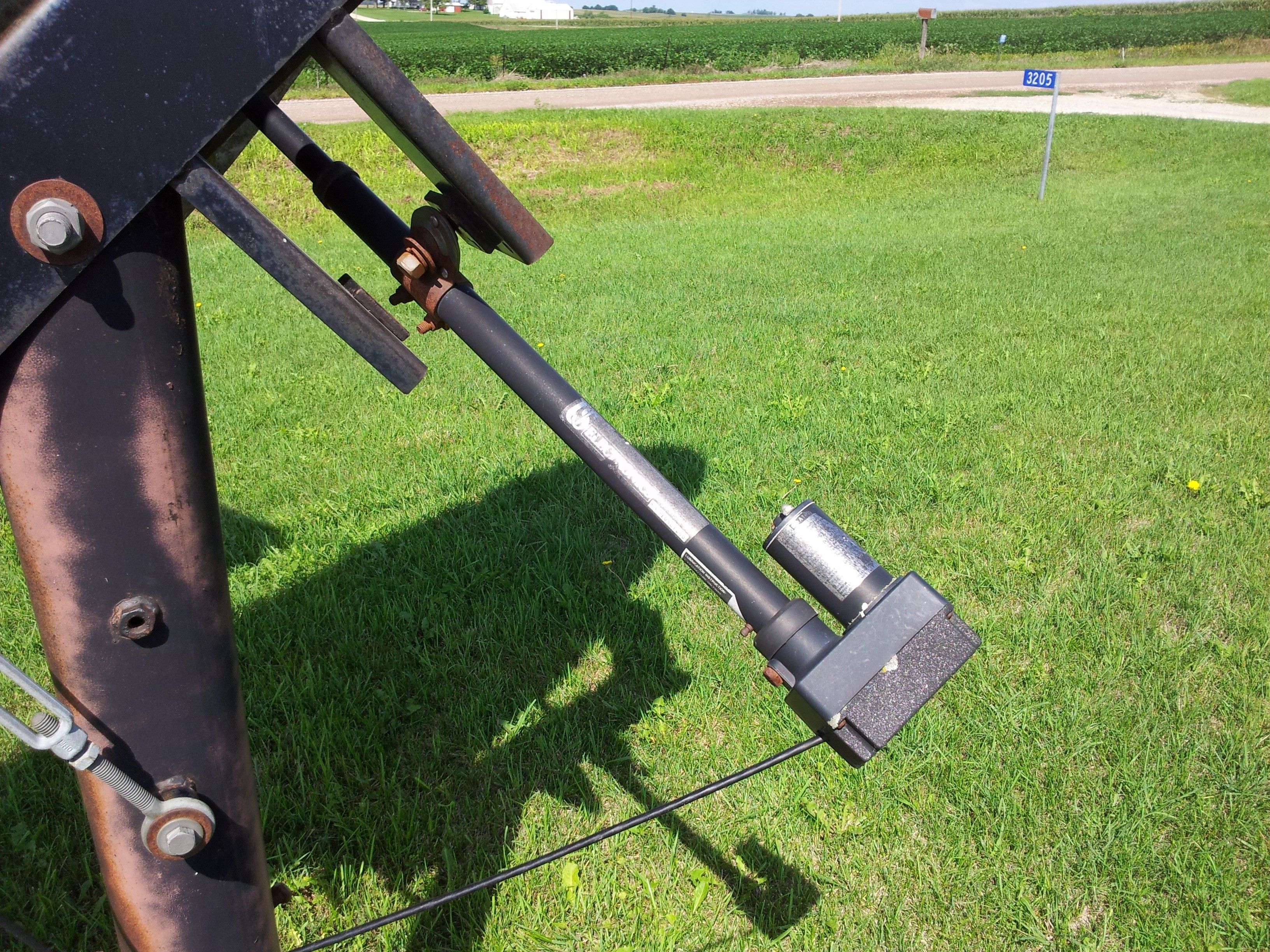

Looking at the Dish #2 above, does it look like it's not a polar mount? I don't see an adjustment for offset angle.

I think first solid Fiberglas dish is a Beach-something.
Beachcraft? Search forum.
We've had a few pictures of 'em
Can't offer any more, but it might be good starter.
Second is Channelmaster. 8' & 10' are common.
We have many great threads on refurbishing them.
On the 8', the LNB legs attach very close to dish edge.
On the 10', the LNB legs attach inboard about a foot or more.
So from your picture , I might bet its 8' (best you measure)
