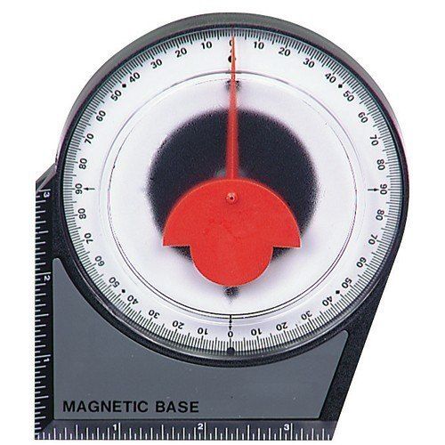

For getting pretty close to required angles, here's an inexpensive device all sat-guys 'n gals need:
Angle meter - Harbor Freight
The picture-link in that thread doesn't work, thanks to the Harbor Freight web site moving it around, so I've added it below.
Of course, inventive members here, have posted home-made tools based on a plastic protractor and a string with a weight on it.
For the more serious, electronic inclinometers with LCD readouts are available:
Angle Meter & Big Button Remote
