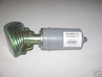

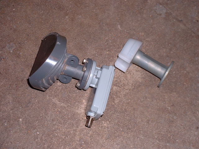

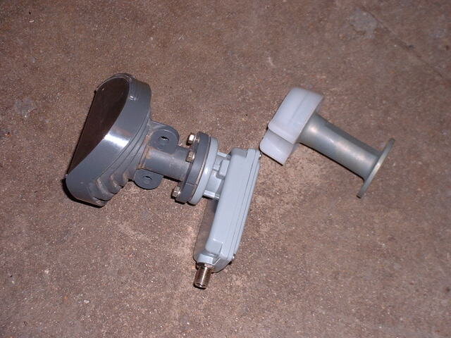

Here are some pictures of your feedhorn, mounted to several different LNBs.
Should be self explanatory: Loosen. Twist. Tighten. - :cool:

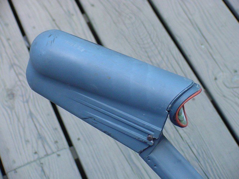

hey thanks for the pics, but I don't think my lnb is quite like any in the pictures.
I'll take some photos and upload them tomorrow.

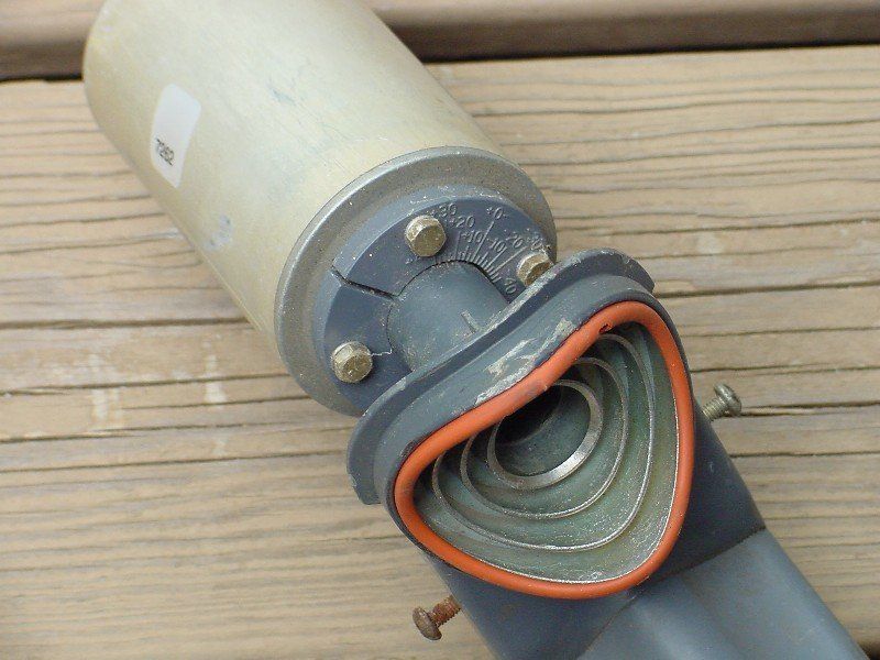

when I tried to photograph my lnb, I zoomed in to get good detail and low and behold I "saw" gradation markings. now I can "see" how to adjust the skew on the lnb (even tho' it doesn't look like any of the thumbnails Anole uploaded).
I should be good to go now. this weekend looks like it's going to be dry enough to climb up on my roof. I'll post back, hopefully with some good news and not more questions about how to do this or that.

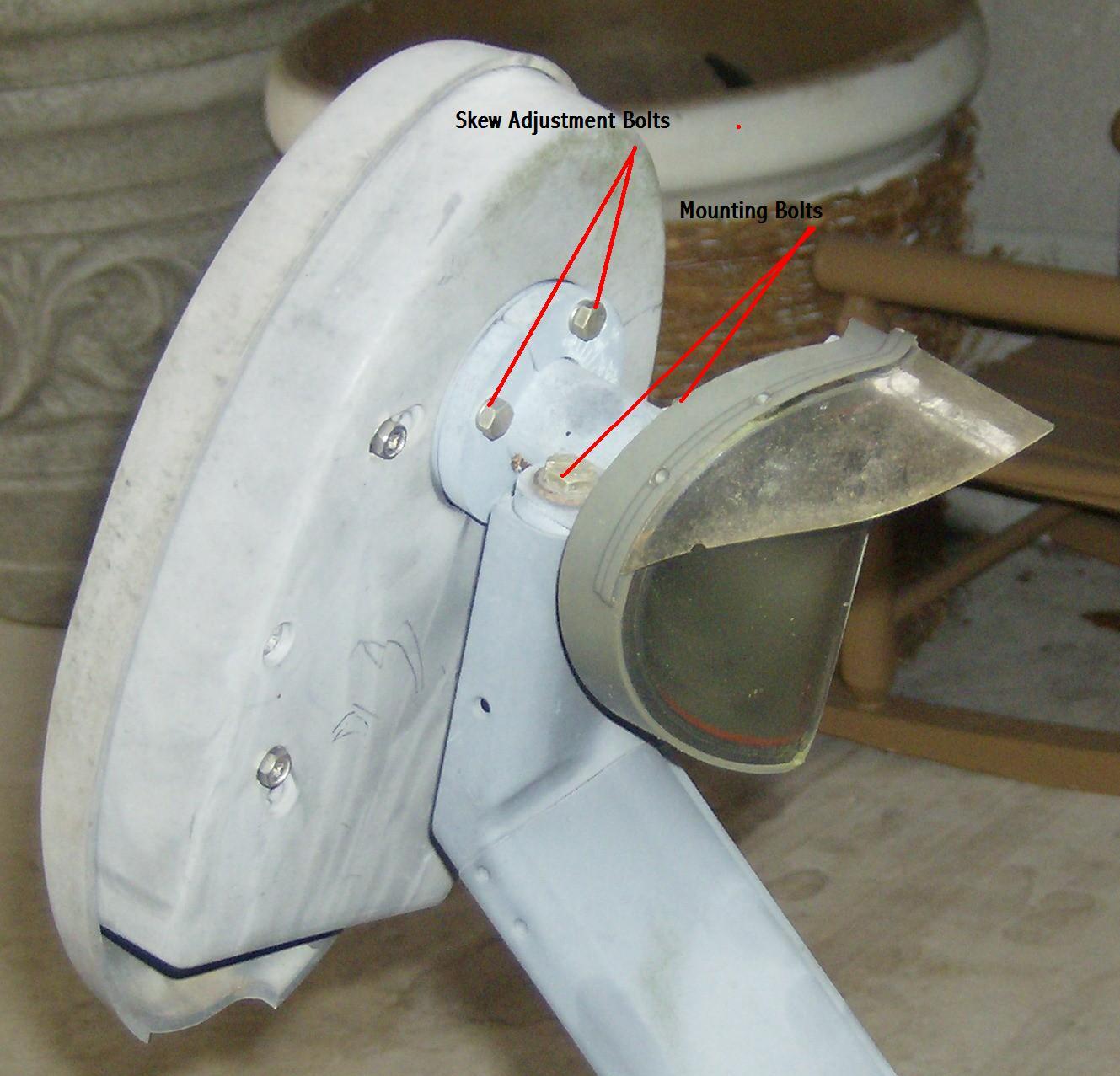

If you'll click on the first thumbnail, you'll get a bigger picture
If you click on THAT picture, you'll get the full actual size picture I uploaded.
This used to be a lot easier, but ...
Anyway, if you'll look at the full sized first picture, you'll see the bolts that hold the feedhorn to the dish-arm, and the bolts which you loosen to twist the LNB for skew.
There are also other different-looking LNBs, but those were the pix I had on hand.
Should be good enough to show you where to stick ... uhhh... the wrench. :)

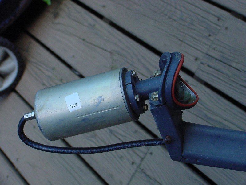

here'w what my lnb looks like...
the gradations are on the end where it attaches to the arm....
