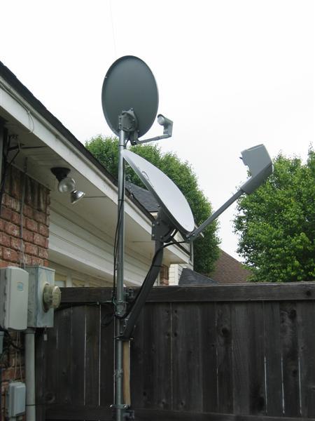

And I'll ask this here too ... for you installer type guys: is it possible to put 2 dishes on 1 pole (110/119 + 61.5)?
Here's mine:
Its a ten foot 1 5/18" pole driven about a foot into the ground and bolted to to the fence post (2 3/8"-three feet in the ground) with U-bolts. Its been that way for over 3 years. I swapped out my Dish500 for a SuperDish last fall. I have never had to repeak either or them.
