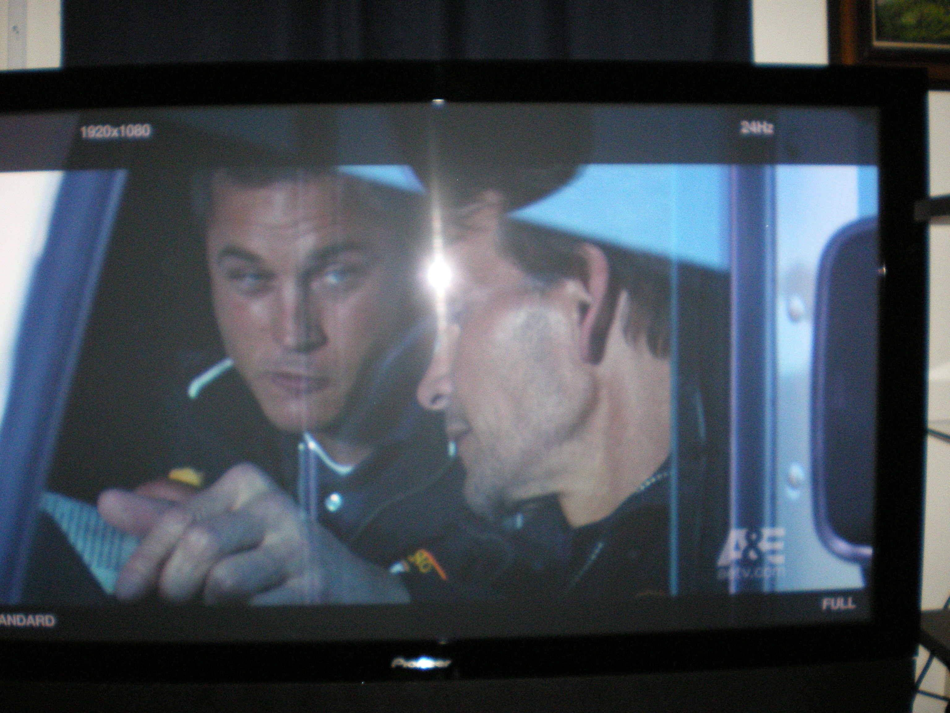

We could finally solve this mystery if only your Tv could indicate if it's a 24p or 30p signal. Why dish would use 30p is an entirely different question, unless it's by accident.
Here You Are: IMGP0001.JPG
Are you passing your signal through a receiver (stereo for example) that might be upconverting it by any chance?
mine works watched last night in 1080p tv does not display frame rate going through a 622 and nothing else all other HD from dish the tv shows 1080i
