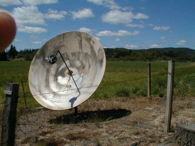

Nice Solid 3 meter BUD right in my neighborhood. Go figure.
I've been driving by this one for a couple years and never see anyone home. Thought it was still in active use when I thought I noticed it had changed azimuth, but finally concluded I (might) be wrong. This place is only a 1/4 mile from me. I had some time to kill today and pulled in and rang the door bell with no response. Noted the name and address on the mailbox and called when I got home. An old widower answered and said I could have it. :) He hadn't used it for several years and the only other person to ever ask for/about it, wanted to use it for target practice. :mad: (how could you miss a 3 meter dish.) Fortunately the old fellow gave him a firm "NO" and it still is unharmed. Not even a dent. Nice spun aluminum dish with a weathered paint job. (Almost tempted to strip it and polish it. He He!)

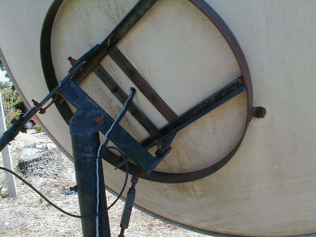

I took a few picture and I will upload some now.. I will have some questions about the "lack" of a Declination angle adjustment on this dish. I don't think you can see this omission in the pictures but I just can't see or imagine how that would be accomplished.

Not bad for free, lol. I think you could prob just take a torch and cut a slot in either that top or bottom bolt holt , and make your own declinaton adjustment. Some older dishes came with a preset or builtin decl of 5-6degrees, was ok for c-band, might be tough for ku without an adjustment. Wonder what brand that one is.......

My mesh dish has a declination adjustment but it can only be set or changed by partially removing the dish from the mount. I tried that once and nearly lost it. The next time I hung the dish on my "cherry-picker" boom on my tractor loader. I still don't have that sorted out. (Yet another story).
Since I'm a welder (with only one eye, still working) and a half ass machinist (with a full machine shop) I'm going to do this one right and I'll be able to fine tune the angles down to a "second" of a degree. The elevation on this solid dish is just a turn buckle and I may make an improvement on that, depending on how much play there is now.
I just looked at the pictures I posted and noted that the dish face look "wrinkle" but it as actual very smooth and the old primer paint must have etched the metal. I was just joking about leaving it shiny. I'm afraid of blinding some aircraft pilot. (or maybe I could use it to focus a laser on the desired satellite. He He!) Might make it easier to spot my place on the next Google/MapQuest satellite shot. :)

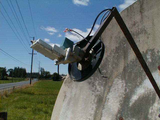

BTW. Is it still possible to get the dome covers for the Chaparell LNB mount??
