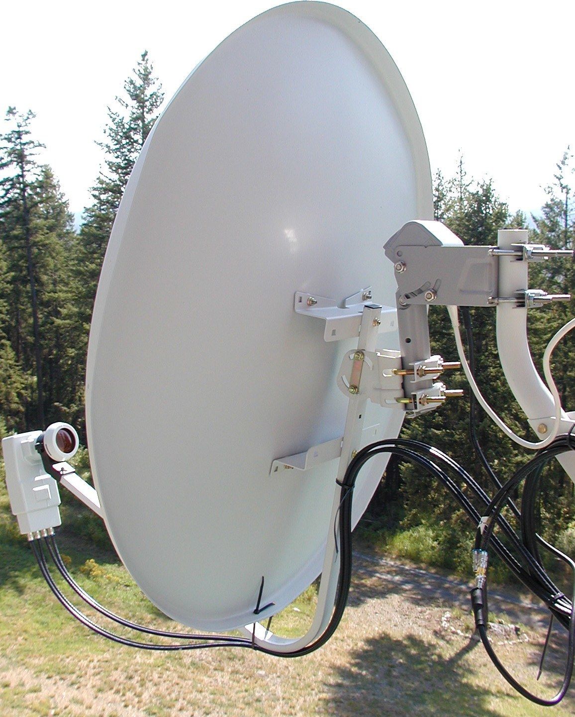

Here's a picture of the back of the antenna taken a few days ago. It's pointed at 101W at the moment I think, and the switch has been re-installed since this picture. (The L and C ports on the right side don't terminate anywhere, they're just hanging around. I didn't realize it'd be a problem to throw then at the switch too, since it has four ports and everything, but I guess it's just more then the receiver can handle, so they're flopping in the breeze while the other two do all the work.) I'm not sure because I've disconnected it until the problem can be resolved. I'm sure it'd be pointed at 119W by now if it was connected just like it is in this picture:
