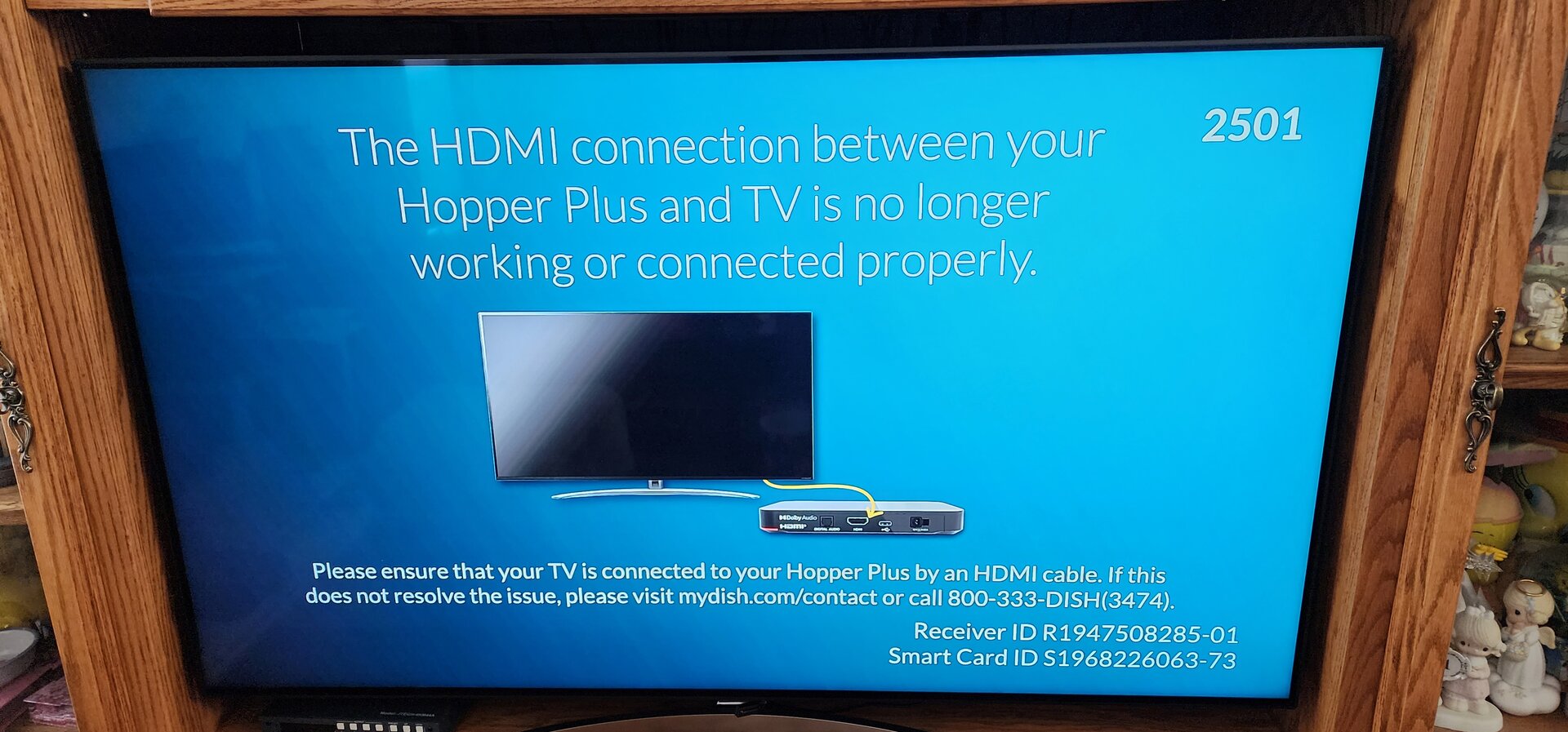

Thanks Bobby. I wished I had known that the HDMI connection screen would of been there like things were stuck. A scroll bar would have been nice. Any future folks that do this procedure I will let them know about it. Got a pic to show them too. Remote control response actions are super fast again, really awesome. I can live dealing with the black screens but not a slow remote.Yep, you have to be patient and wait out the 20 minutes or so. It's best to do the plug in and walk away for that 20 minutes.![]()
It's obviously a scare screen to get the user to keep using the HP.Thanks Bobby. I wished I had known that the HDMI connection screen would of been there like things were stuck. A scroll bar would have been nice. Any future folks that do this procedure I will let them know about it. Got a pic to show them too. Remote control response actions are super fast again, really awesome. I can live dealing with the black screens but not a slow remote.

Well, it's done. Removed the Hopper Plus and now back into pure Hopper 3 mode. WOW, the remote control actions and everything in general is super-fast again. All my Joey 4s Google menu is still there and all my signed in apps still work good. But of course, the Joey 4s slow remote control actions is still there. I am glad DISH is working on that issue. The HDMI connection screen 2501 will display majority of the 20 minute re-boot time. Just sit back and wait. Thanks to everyone getting me thru this stressful process. Glad it's over. LOL. Can't wait to re-install the Hopper Plus again when the issues are resolved.Scott Greczkowski and HipKat , I am going to remove the H+ and go back to pure H3 operation. Will re-connect the H+ someday when issues get fixed. After J_Smooth tried the same thing and had issues, can you check the following procedure for anything I should do different? Thanks
Unplug the H+ and H3 electrical cord.
Unplug the H+ USB connection
Unplug the H+ HDMI cable and plug into H3
Plug-in the H3 electrical cord
After 20 minute boot up hopefully everything will be up and running
Re-boot the Joey 4s if needed

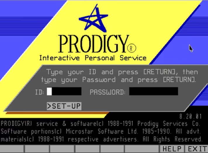

More like ProdigySeems like the H+ as it is now is comparable to Windows 3.1
Man! Been a LONG time since I seen that!More like Prodigy
