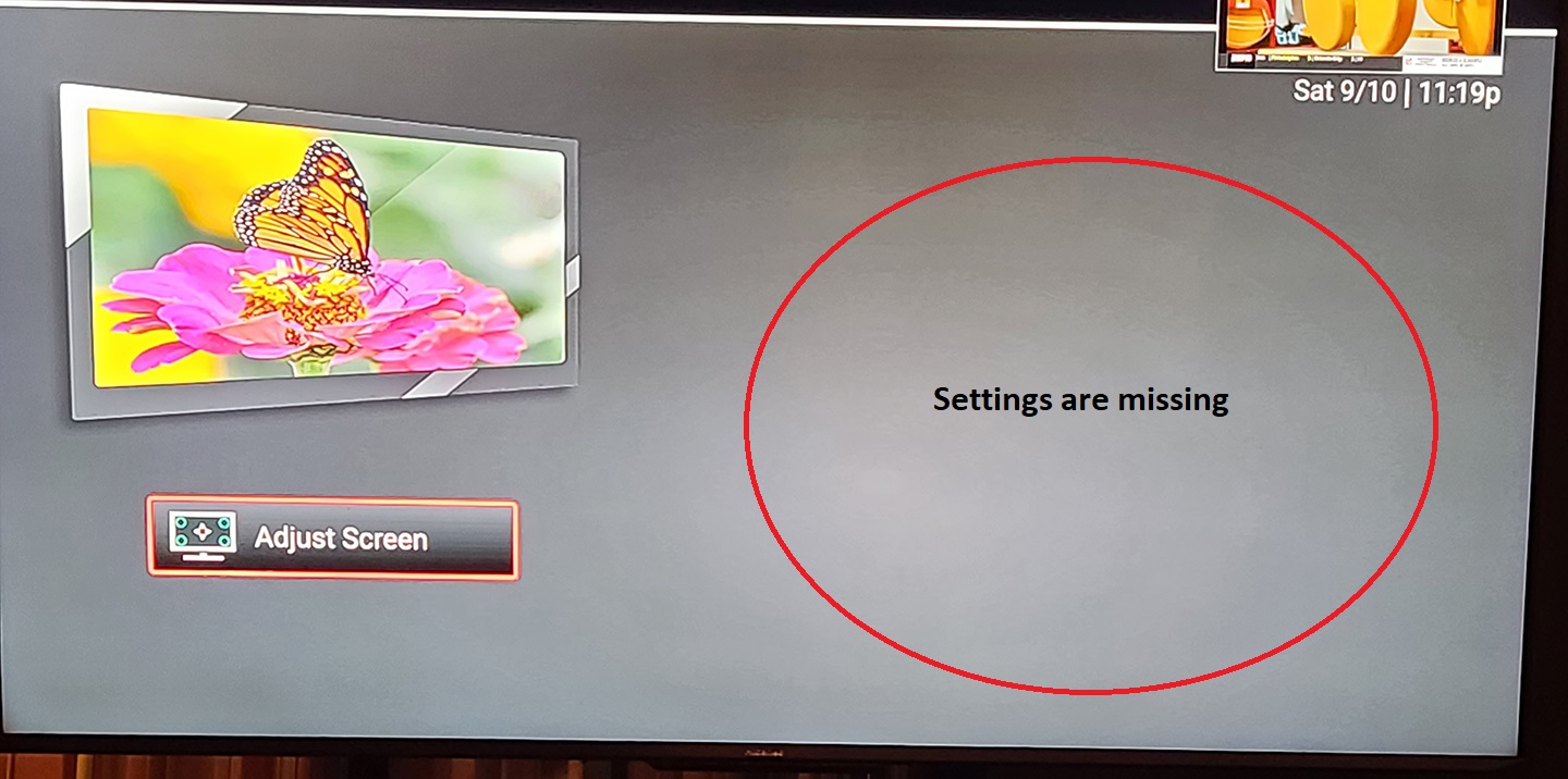

Ok, here's what I have learned so far....
1. Joey 4 will work on a Hopper 3. This configuration still allows the Joey 4 to see the 4K channels 540-1 and 540-2
2. Each unit Hopper + and Joey 4 have Android TV loaded on them.
3. There is a major issue with each unit up-converting every video signal to HDR.
4. Each unit is missing the ability in Dish settings > TV to change the Video Resolution and Aspect Ratio.

I am sure there are other bugs but I have been focused on the video signal at the moment.

Which is exactly how it's supposed to work. I can't believe Dish allowed these thing to be released like this. There is no way this is acceptable. I have spent a lot of time calibrating my TVs with proper equipment for my viewing areas and to have the ability to use those Picture modes unavailable is crazy. I was watching football last night on NBC and the HDR up-converted picture looked awful!
