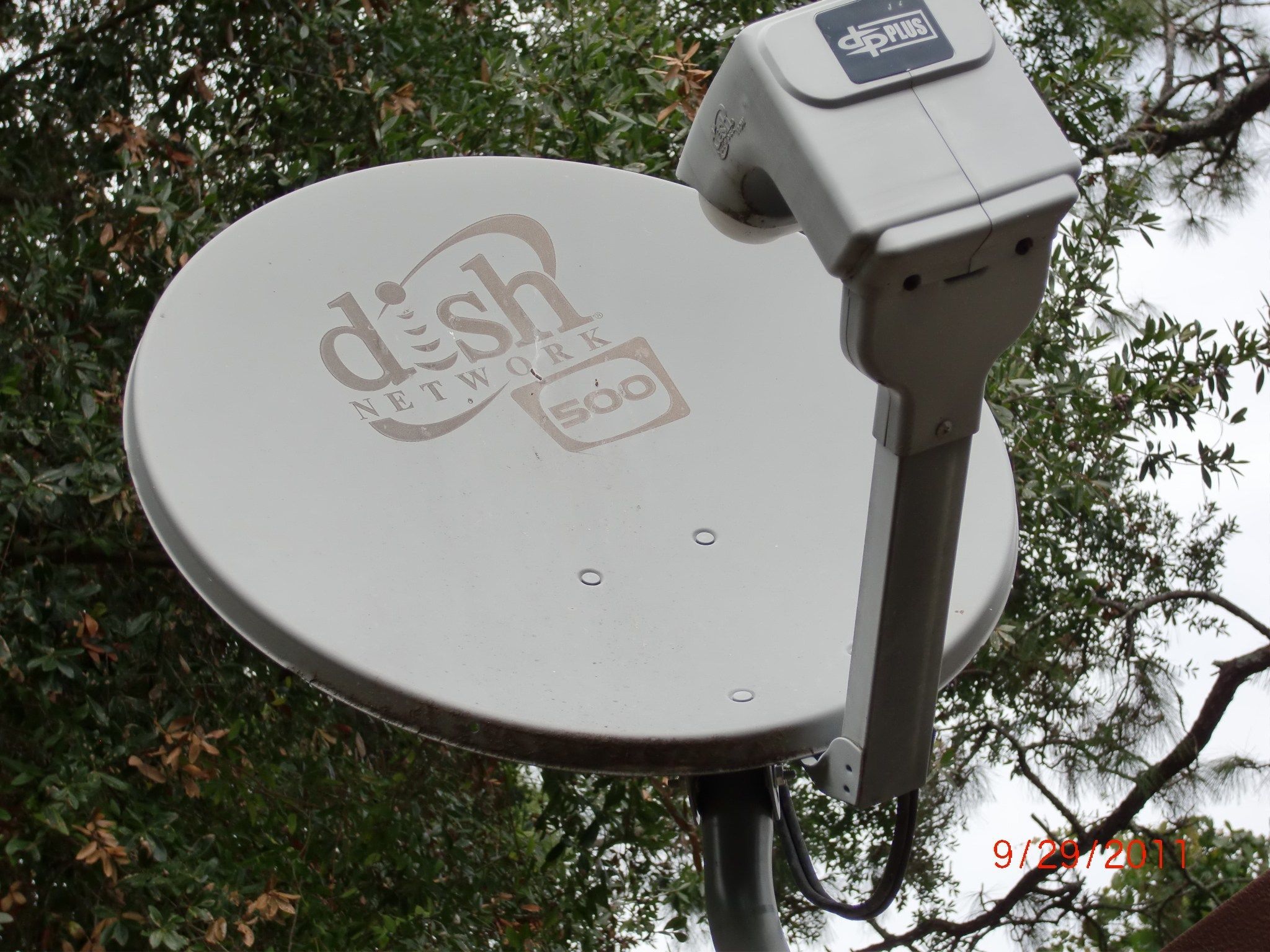

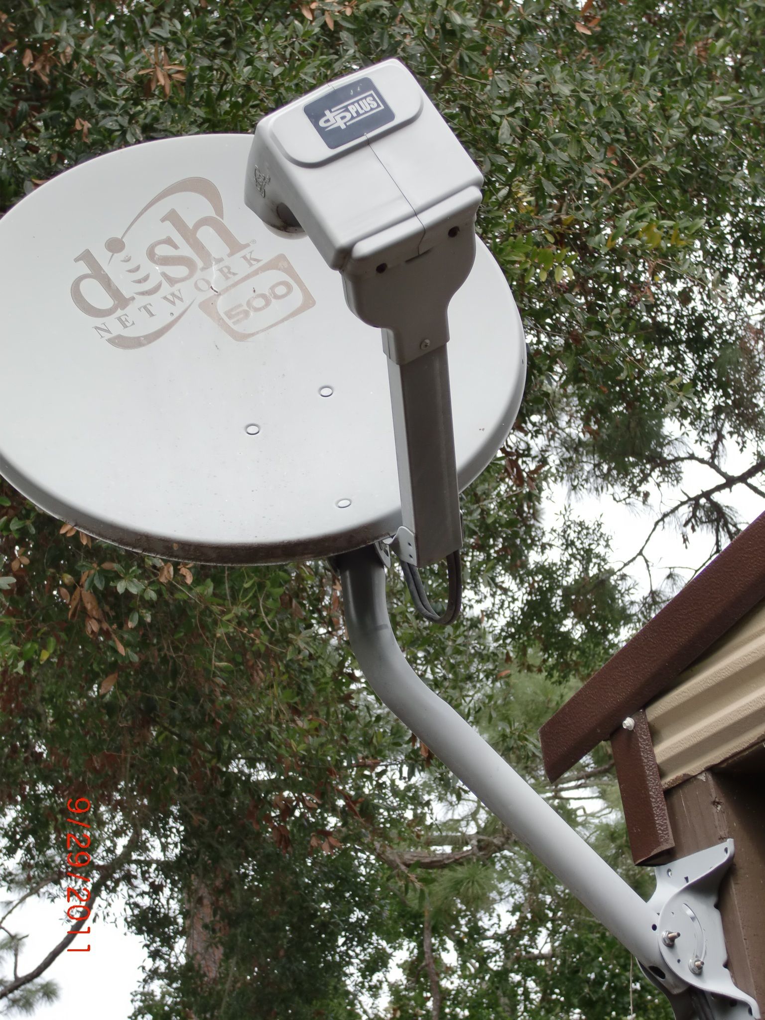

Here's a couple of pics of the Dish Network dish I am trying to see if I can use for FTA. All it says on it is DishNetwork 500.
Any help is greatly appreciated.

Unfortunately that one won't work for FTA. The LNBFs on that are circular polarization. You need a Linear LNBF. The dish itself is not really big enough for good KU reception.

I tried the TurboHd dish that dishnet left behind and a 500 from a friend.
With the TurboHd I am able to get over 200 channels on 97W or G19 satellite which is kinda hard to do for a beginner, but not impossible.
With the 500 it took me over 1 hour to get about 10 channels on the same satellite, this dish is way to small and extremely sensitive for the slightest movement or adjustment and for an beginner and to small for most satellite and channels for FTA, I just wanted to see the difference between a bigger and smaller dish.
Also, on both dishes I had to extend the LNBF-arm by 1-2 inches to get focal point right , using a linear LNBF.
Using a 36'' or bigger dish is recommended.
