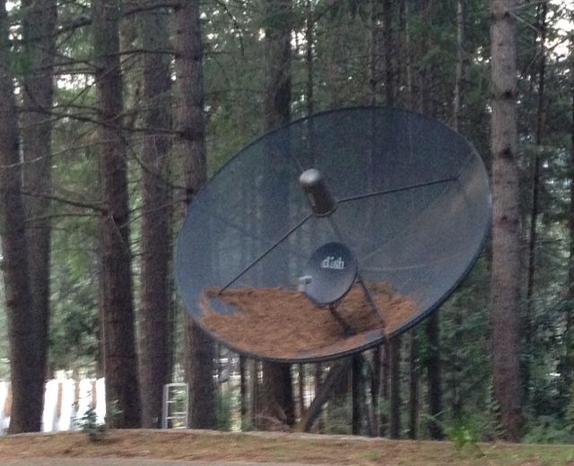

This is how a typical Dish Network installer would add their service to your BUD.
