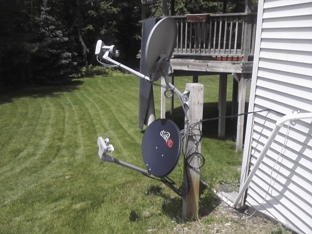

Not my install but this 500+ had been there for a long time, no warpage and still had signal strengths within dish specs.
1k4 added.
This would be an auto-fail for mounting where I work..and they'd have something to say about how that cable at the top of the post goes across to the house like that.
