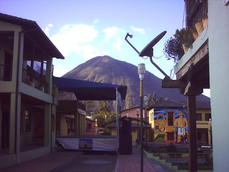

I've been meaning to post this for a long time, but I saw it again today and thought I'd better do it.
I was in Ecuador awhile back and went to the "Mitad Del Mundo," which is a tourist spot on the Equator. Outside a little bar I saw this dish. Since that's mere feet from the the line signifying where the equator is (it goes under that awning right behind the dish) - I assume the angle on that thing is about as high as it goes!

I measured the picture with a protractor and get an angle of about 50 degrees. If you add 20- 25 degrees for the offset you get around 70-75 degrees, but it should be at 90 degrees. I don't get it.:confused: Which way does the equator run in that picture? Parallel with the side walk or perpindicular?
Well, unless it is pointed towards its "true south" or "true north" satellite, it will be not 100% straight up. It will be angled east or angled west.

Yeah, I forgot about that. It's still a lot higher than I'm used to.

TRUE
The more I think about it , as long as the elevation bracket is set on the True North or South ...
it would be ready as a poor mans H to H as long as you have an East to West above your head LOS.
Must be pointed at amazonas at 61 degrees. From that location it has an elevation of 69.5 degrees. There are a few other sats that are in the right elevation range (61-67W or 91-97W) but the footprints or dish size rule them out.
Satellite calculators are very helpful.:o
