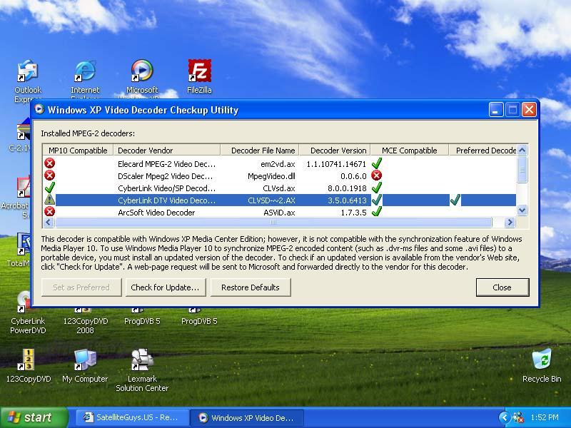

Cyberlink has some advanced codecs in Vista that should work good for you. Microsoft has a little utility that you can download from there site that allows you to see what codecs are installed on your PC and allows you to set what you want as default.
