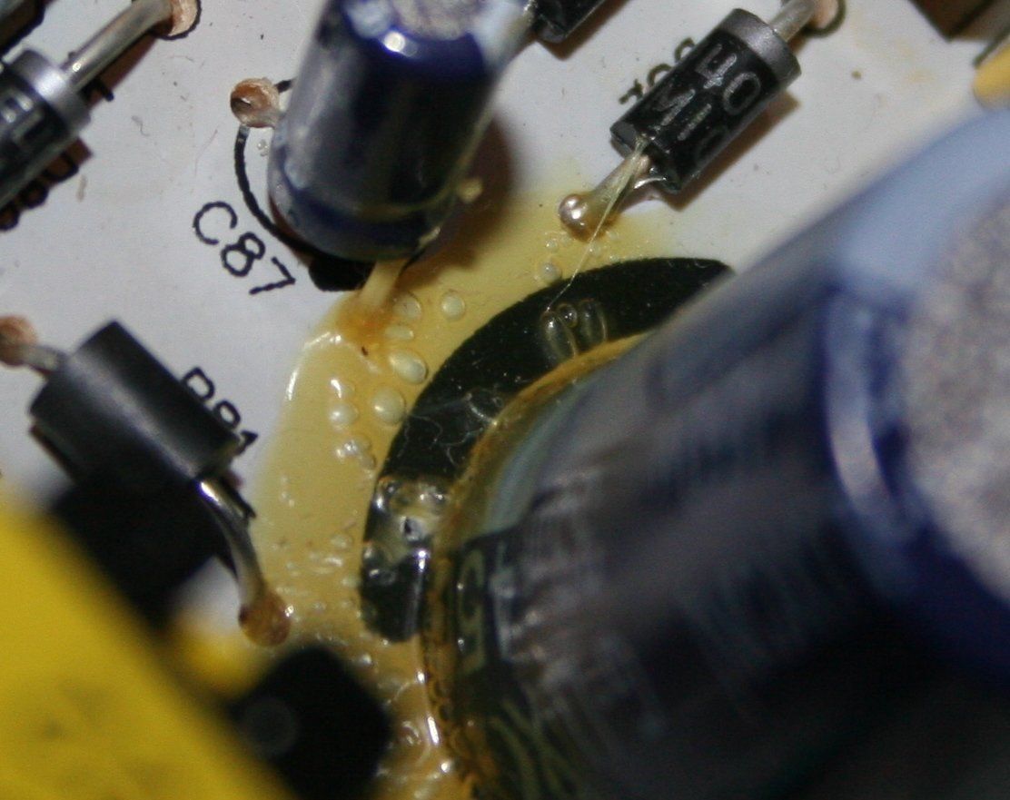

I haven't been able to work on this for a couple of weeks (I've been getting into robotics. Fun, fun!) but tonight I gave it another shot. I hadn't noticed this before, but does this look like some weird glue or some cap juice? Please tell me cap juice. I can fix that!
