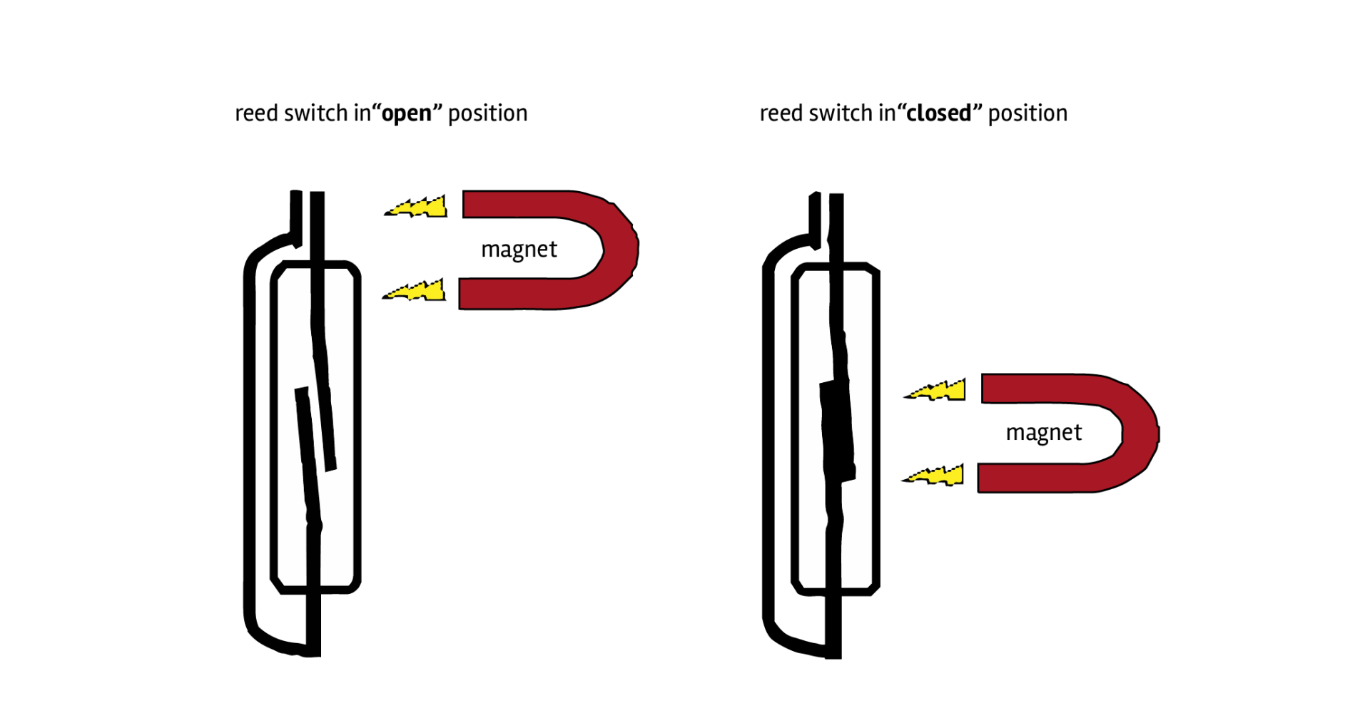

Actuator sensor cable needs to have a dedicated shield. 2 wires plus shield for reed switch actuator sensors. 16g seems to work just fine here. Stranded, of course.
