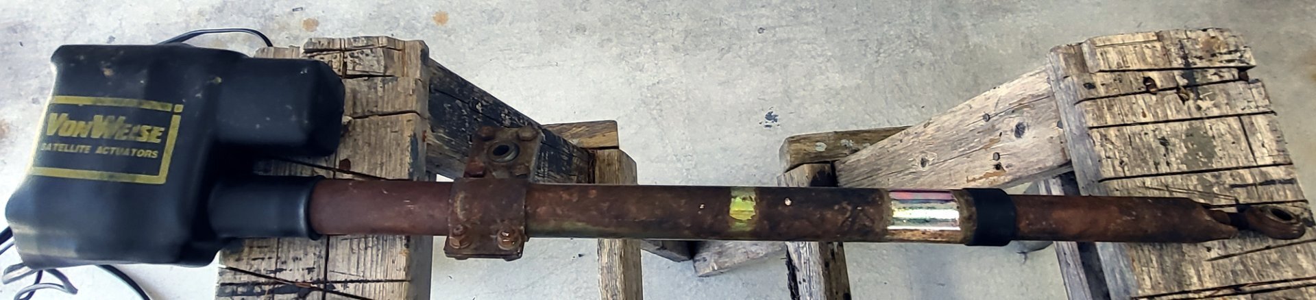

Since the VBOX7 has been successfully acquired and is confirmed en route to me, I will remove my Von Wiese jack now, open it up and see what it looks like inside. I might try moving it with a power supply just to watch it move.
Reactions: FTA4PA
I'm always on this. A protective measure. Remove the gearbox first and see if you can turn the actuator shaft by hand.
Then power the motor (count the output shaft turns so you can reverse the motor leads and get it back where you started).
Doing so will keep you from powering the motor in a stall and save the limit switch diodes from shorting or opening due to over current.
Reactions: FTA4PA
I'll keep this in mind. I decided not to use my (good) power supply that's the heart of my radio station. I'll wait for the VBOX to arrive. The Von Wiese is on my work bench waiting. It actually appears in good condition after I wiped the spider webs off.

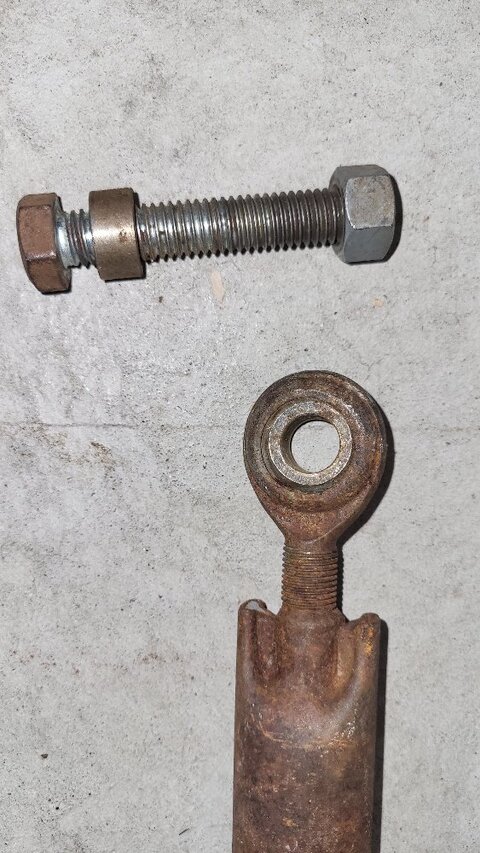

Added: I tried to loosen the nuts on the Declination bolt. No movement. One appears rusty; the other doesn't. So I coated them in PB Blaster to leave overnight. Maybe they'll budge in the morning. Otherwise, I may have to live with the 44 degree declination setting from Nova Scotia.

Looks like mine, the "eye" bolt had broken off, I figured out through trial and error at the hardware store that it takes a male 1/2"-20 thread to a 1/2" bore eye bolt, cheap on amazon: Amazon.com
Reactions: FTA4PA
A good soaking in penetrating oil. Some raps with a hammer. A heat with a torch and quench and more p. oil never hurts. Wiggle-wiggle!
Reactions: AZ.
This stuff works great. Make sure you use it outside though. The smell can be overwhelming if used inside....
Exactly what I'm using. It's good. Hauled it across Canada when I moved since it loosened the mount bolts years ago and impressed me then. Even outdoor it smells bad.

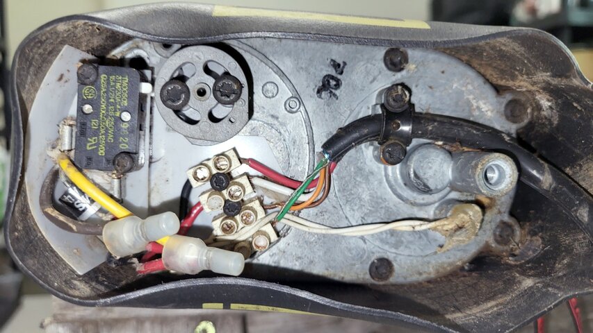

I received and am looking at this item now with my own eyes. Though the box appears well used, the AAA batteries are still sealed in plastic as is the remote control. Everything appears brand new with no surface scratches at all on the unit itself. Plugging it in, the unit powers and appears to work correctly. Read your facebook ads: you never know what you'll find!
I tried connecting the VBox7 directly to the Von Wiese just in case I might be lucky again and it might move the actuator. Nothing. 'Err2' resulted on the VBox7 display. Same as when nothing is connected to the box's sensor input connectors.
So I measure 0 ohms on the sensor wires. Is that correct? How can I remove the tight boot over the actuator body?
Actuators are 18", 24", 36". Where is this measure taken?
Reed switch sensor. Close to 0 ohms when closed, infinite when open. Loosen the magnet and try to turn it while measuring resistance.
Reactions: FTA4PA
Not sure how I would do this. I only have access to the bottom of the actuator where the wires enter for connection to the terminal strip. I believe I see the reed sensor covered in waterproofing material.
Slap up a good photo showing the sensor section. As always.
