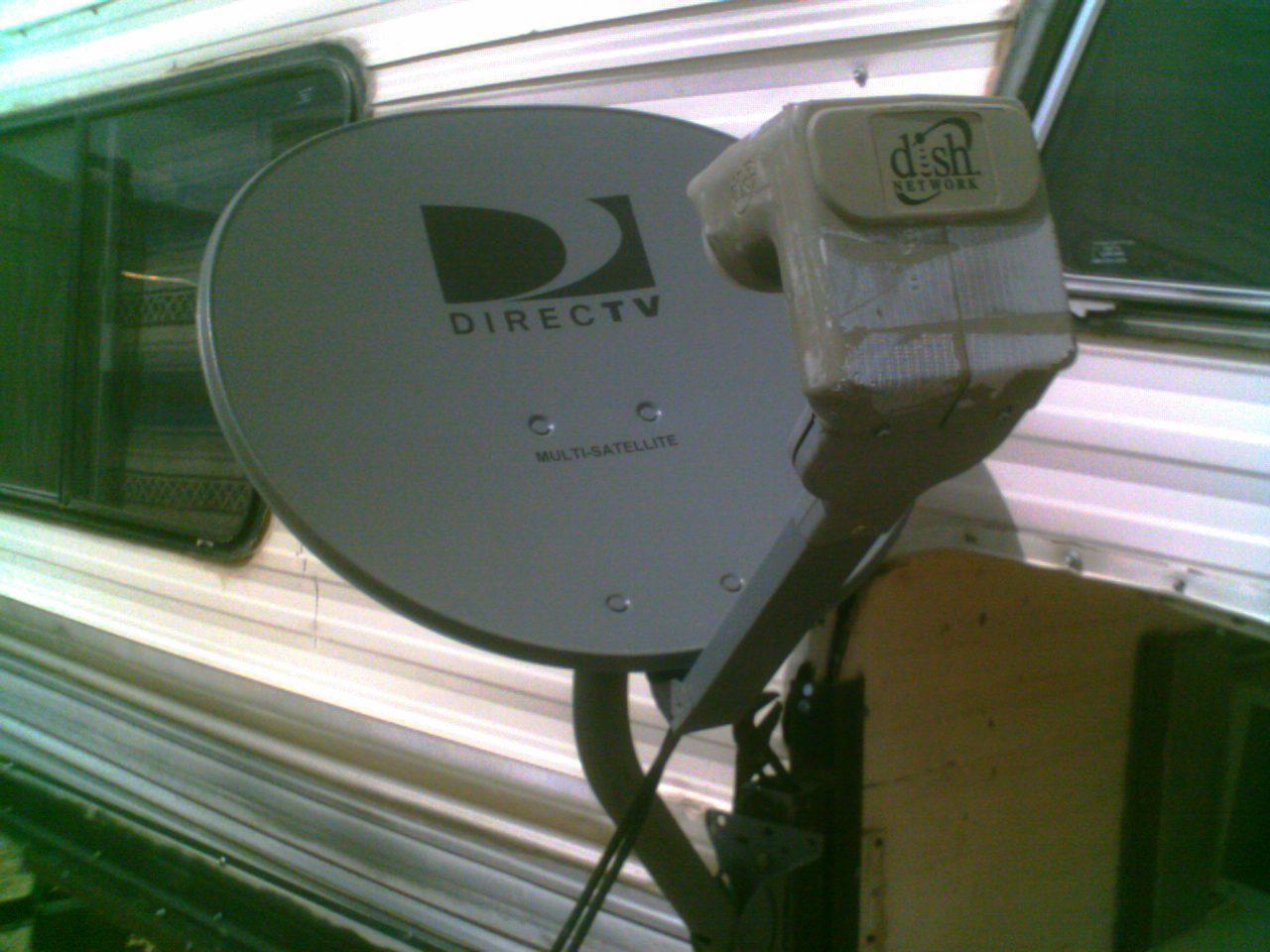

Went out to my old camper taking a non subbed Phillips D* SD receiver, a Echostar 2700 non subbed receiver and a Phase III dish I acquired today. Dish 500 already beside camper. (camper has 20" Apex SD flatscreen TV, a refridgerated A/C and an Icebox stocked with cold beverages...temp when I entered camper 106.5) I left Dish 500 arm set on 110/119 when I put the Phase III on and had marks from the Phase III arm...
attachment 1) Dish 500 arm on Phase III dish (hint, do not use duct tape to try to attach extra LNB for 129 :D )

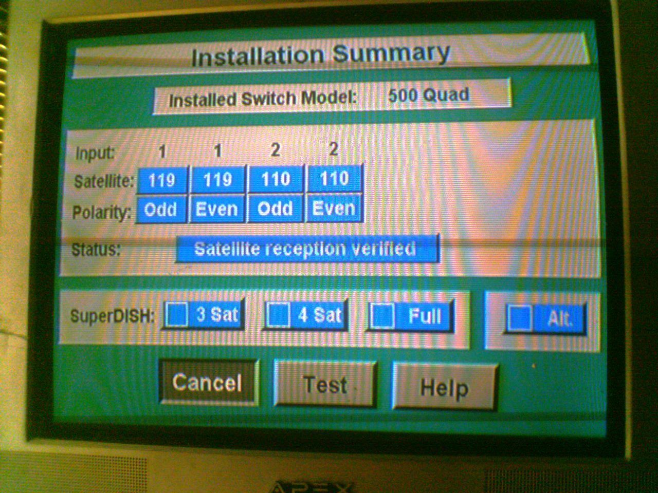

attachment 2) Results from switch check on Echostar 2700 receiver

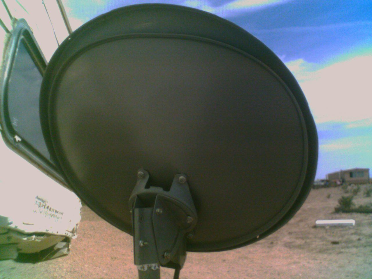

attachment 3) Dish 500 rotated 90 degrees and placed over the Phase III / Dish 500 hybrid ( No Signal when I did this)

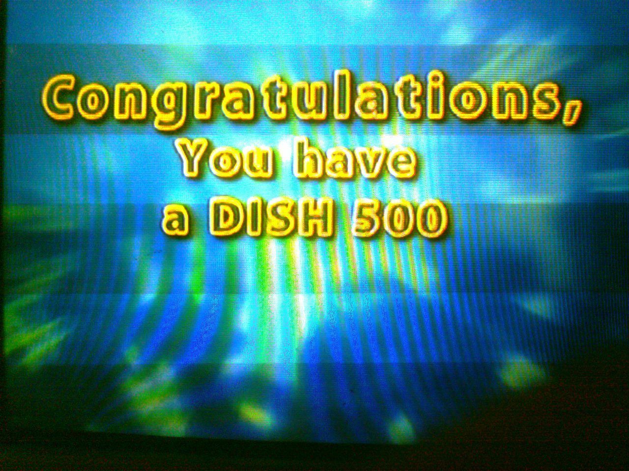

attachment 4)Congrats you have a Dish 500 ( Not!)

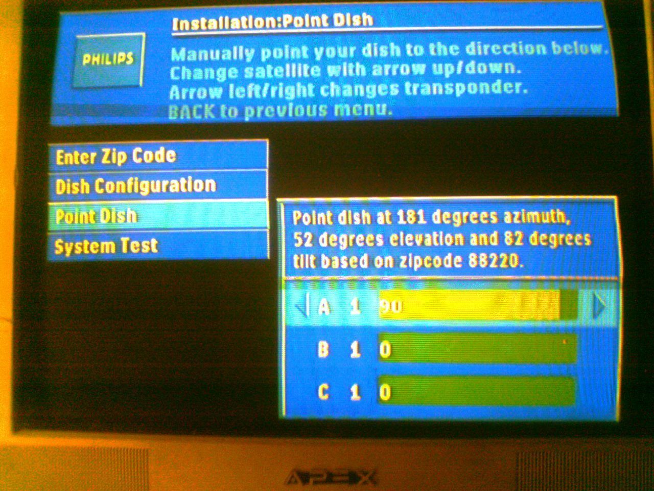

attachment 5)Installation/ point dish screen on Phillips D* receiver, I was only able to get sat A with both dishes with the Phase III 80 (not messing with elevation on dish, just cranking the camper jack up and down )as you can see with the Dish 500 a 90 ( fluctuated between 87 and 92)

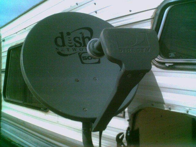

attachment 7) Dish 500/ Phase III hybrid
Did not tweak too much as it is around 100 degrees out there :) the holes are not exact matches, but they usually are not either on supposedly matchable components. The Dish 500 rotated 90 degrees is slightly bigger and might add some gain in signal if the holes could be drilled and it could be shimmed right.

I tried that too, rotating the D500 pan 90 degrees, and I didn't get no signal either. I didn't expect that focal point thing having to be THAT precise. Well I thought I give this a try, because if it had worked and the signal was improved with this mod, or at least about same signal and less sensitive to rain fade, then this would have been a REAL simple improvement, as you only had to swap the pan, and NOT the whole Dish with re-aiming and all that jazz. Still don't know why Ice's simple slapping on a dual to the side of a D500 worked at all. My old D500 had about the same signals on 119/110, but only dropped a few points in even the heaviest rain. The new D1000 can be having the same signal in the sunhine, and when it rains...BOOM...down the signal goes 10-20 points right away. This dish really sux in the rain, not just on 129.
