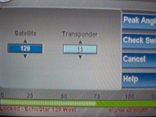

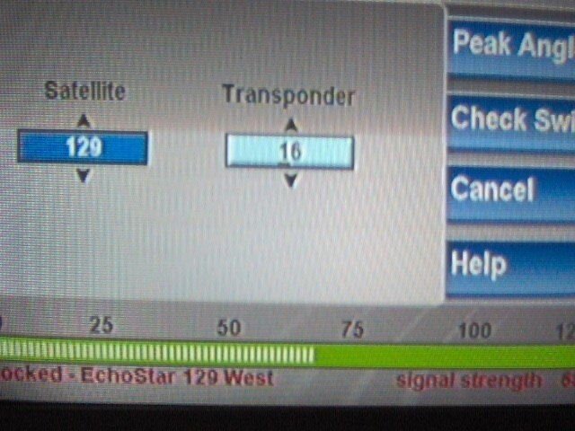

SIgnals were 110+ on 119, 100+ on 110 but only 75-77 on 129

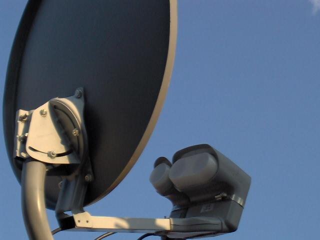

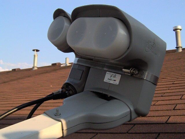

I posted pictures. Mine was a jerry rig job when they first turned up 129 so I didnt mess with 110/119...I just hose clamped a LNB next to 119 for 129 :)

When you try to aim at 3 slots at once, you're bound to have some issues. My way was 2 slots at once and then the 3rd was done later :)
Ice, your setup shows, that the 129 Dual is actually even more off center, than with a W-bracket, and you still got mid 70's. So if I swap the pan, in theory it should be even better. Look very close, and you'll see that the W-bracket would move the Dual more to the center, because on a W-bracket the 119 sits right in the middle. On a D500 with thw Y-bracket 119 and 110 are both off center, so basically the Dual for 129 would be sitting kinda were the Twin sits on A D500.
I havent seen a D1000 in person so I don't know exactly what LNB is aimed where.
The dish500 is offset for both LNB's...the 129 I just slapped up and got a 75 in MN, where its tough to get to being with (and that picture was done about a week after 129 was turned up)

A mid 70's on a 129 is not all that bad. I'm rather amazed that a simple hoseclamp works to bring it all together. Props dude!

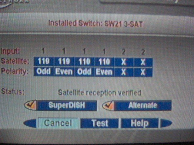

considering I live in MN (where its tough anyways) and that was about 5-7 days after Dish moved E5 to 129 that was pretty good. If you notice the receiver couldn't acknowledge the satellite at the time (in the check switch screen) :)
