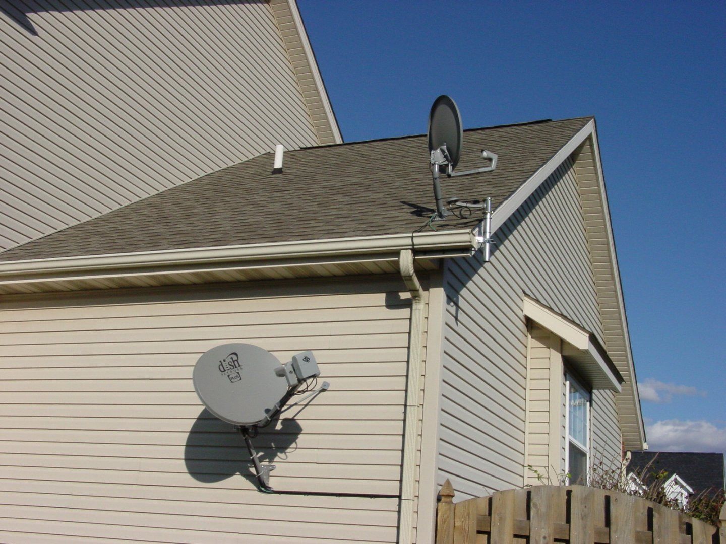

I wonder if the 1000+ and 500+ reflectors are identical! The measurements are at least the same. I kind of don't want a wing dish again. When I joined DISH in 2007 I had to have five sats for everything I wanted. My wing dish was 61.5. This was because there was one lonely channel that I wanted that was on 61.5 only and the HD locals in the St Louis at the time were on 118.7. So that called for a 1000+ dish at the time. Since then the one lonely channel I wanted is no longer on 61.5 so I go rid of my wing dish when we had a new roof installed. Here is an old pic. The little tiny satellite antenna is for Sirius Radio.

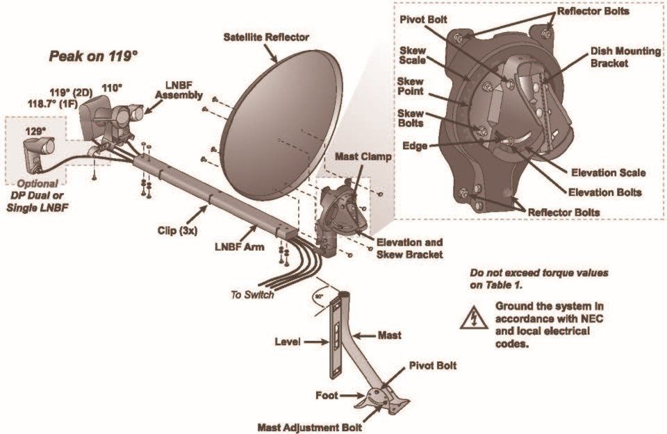

You guys are making this too hard. The 500+/1000+ international dish reflectors are black and have been for some years and that DPP500+ with the DP Dual on the attached sidecar would get the 129. For your Hopper 3, just run 4 lines from all 4 outputs (3 on the DPP500+ and 1 on the DP Dual) to your 42 Switch
Dish 1000.2 19"H x 24"W
Dish 1000.4 20.8"H x 22.3"W....

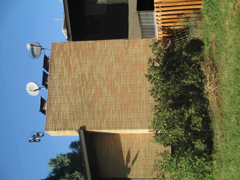

And if they only kept the 1k4 reception would be a dream. But since the 1k2 is cheaper, and unfortunately not really made for a triple pick up, as per several long gone Field Supervisors, well as the 1k4. We suffer. That's why I went back to my two dish set up. Got tired of Rain, Snow Fade and unexplained drop outs. OH and techs saying they could dial it in so far. Plus it's easier to find my house. The one that looks like an NSA listening station.

WOW, looks nice. Thanks for the pic.

I would say it is an old pic. I will contact Mark at Dish Depot and ask him. Can you take another look at the Skew Plate in the 500+ dish? It look likes is has an elevation adjustment rod that I have seen in the 1K4 dish. Do you know by any chance?
https://store.dishdepot.com/dish-500-plus-dish-assembly-for-3-satellites-
It does not have the rod like the 1000.4 does. And in case it wasn't clear, the 500+ and 1000+ dish is the exact same. You're essentially turning the 500+ into a 1000+ by adding a dp dual lnb to hit the 129 sat.
