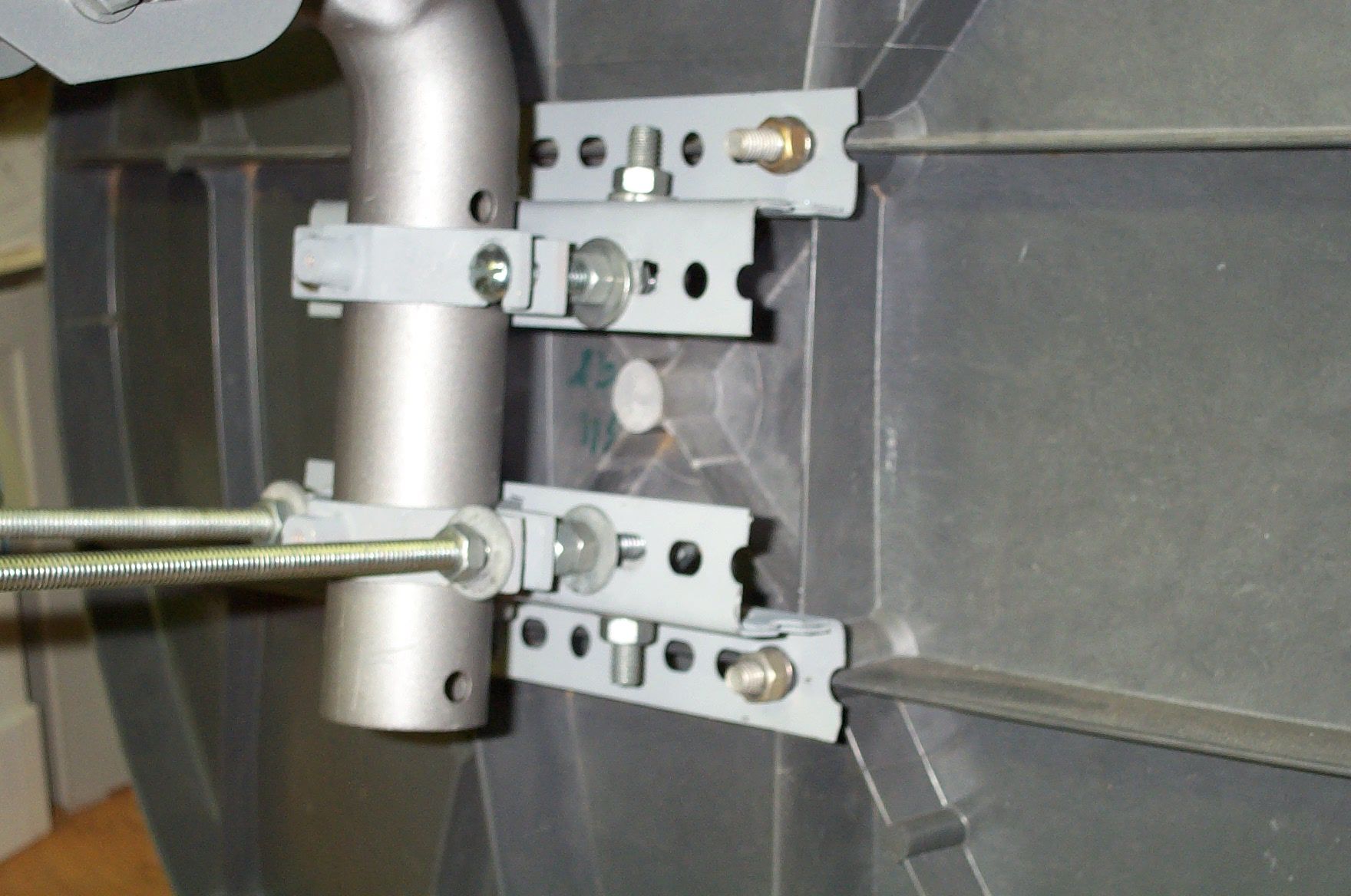

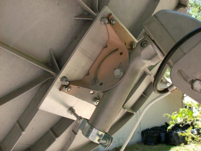

You don't have to buy a motor with the arm that points up-do away with that heavy mount and use most any motor. The dish by itself isn't heavy at all. Fabricate, do a search on 'motorized primestar' should get you lots of ideas. A bunch of us have done this. I'll throw in a couple of pics I've saved for you :
We've answered this question many times, just a few days ago the last time, looking back thru recent threads should turn up the discussion. All you have to do is build a bracket , take a flat board, piece of thin metal, etc to hold the dish to the motor shaft. But you'll have to incorporate a way to adjust the dish's declination, hence the pivot point on each one of those pictures..
