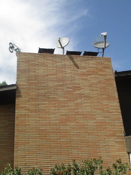

So here are the results . . . any thoughts would be appreciated . . .
Bird x Transponder - Listed / Is
110x14 - 50/66
110x15 - 57/69
110x16 - 58/73
110x21 - 60/73
119x15 - 63/52
119x16 - 62/52
119x21 - 65/52
Wing Dish
129x19 - 40/53
129x20 - 41/50
129x29 - 41/52
129x30 - 40/47
Both dishes are supposedly aligned so that the main birds get the best they can. I got the feeling that the Exec Tech that did the "up top" work, hurried it a touch.

Your readings are all just fine. I had a look on my setup and I am within a few numbers of everything you posted. If you are concerned about your 129 numbers, they are all just fine. 129 has always had lower numbers and work just fine that way.
I agree. Those numbers look like what I would expect from my 129, with a similar setup, using a wing dish for 129.
Cool. Thank you.
Not really "concerned", but curious.
Thanks again.

After reading through this all again and looking at the numbers and 129 which should have no variables such as having to deal with other birds, I'm wondering with the 119 numbers lower than listed, if the 1k2 dish isn't aligned as it should be to get the best for 110 & 119, forgetting 129 since it's on its own?
As I said in my original post, I tested all 3 satellites on every transponder you showed and I was within 1 or 2 of every number you posted. I have zero issues with any channel on any satellite.
That was my thought when I read the numbers, that the dish was peaked for the highest signal on 110, without worrying about 119 as much. Normally, the process would be to peak the dish for 119, and hope that 110 and 129 fall into line as well as possible. In this case, since they did not have to worry about peaking 129 on that dish, they may have peaked it for the best signal on 110 instead. Having said that, all of the numbers look fine, and should still provide a very reliable signal.
On the 110 & 119 I was expecting more from 119 since it doesn't have to compete with 129. I use to sight my own dishes and might go up and play a bit. Who knows what I could come up with. Like I said the Tech wasn't all that into doing it. It really wasn't his job. He was out with a FS and wanted to check out the part of the work order that said a 40' ladder would be needed. He said since he got his ladder out and up the side, he'd do all the work up to. But when I explained what happening he kinda got that "deer in the headlights" look for a second. I also had to tell him how to do the two dish wiring, but he showed me the two Solo Hubs wiring. I have a meter and will go see what I can find out.
So my only remaining question is that if the numbers on 129 are good, why all of a sudden am I getting macro-blocking on 129 programming. Especially since when I check the meter every time it happens and 129 is good. Sometimes really good. So is it DISH or the H3 or Poltergeist? That's why asked about Solar Interference.
You can have good signal and still get pixelation if the lnb is on the skids. Swapping it out would be a good start.
