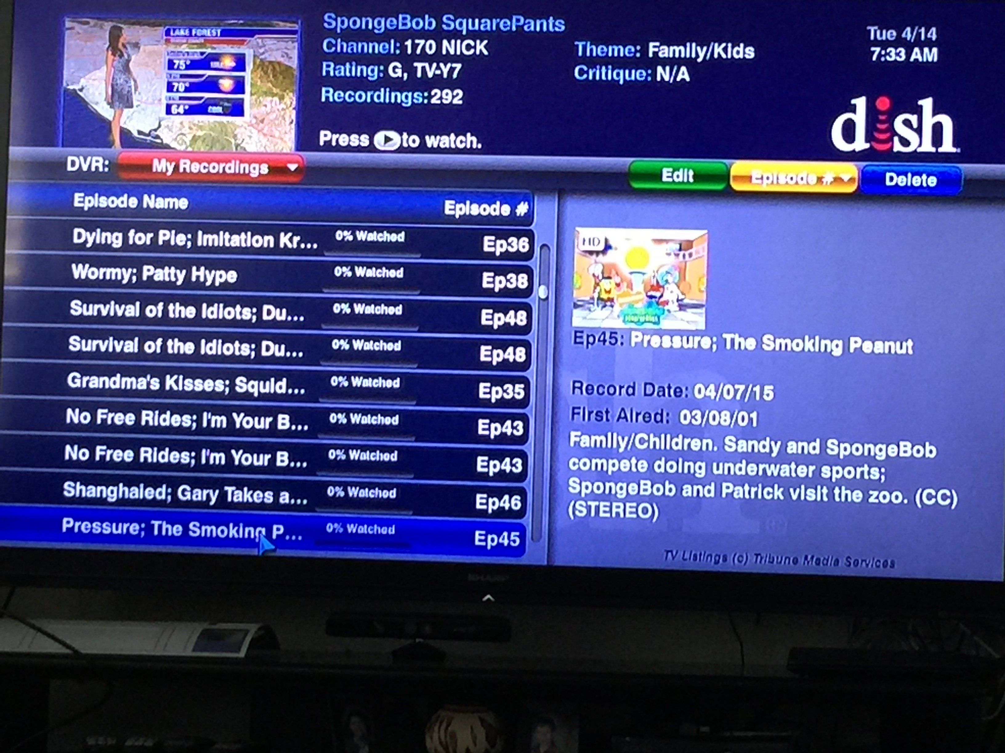

Hopefully here is a pic of the sort by episode that they can't get right!
