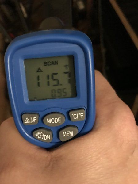

My new dual tuner dongle gets to about 118 degrees F, according to my infrared temp gun.

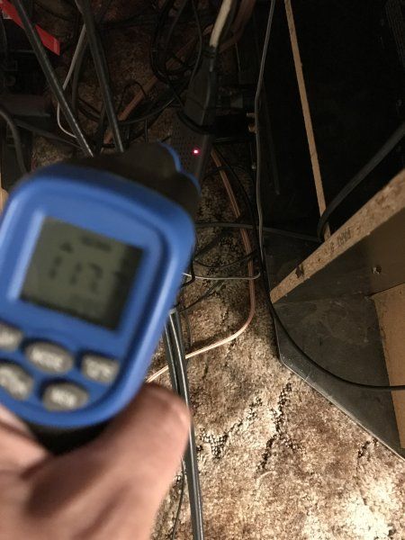

View attachment 127999 My new dual tuner dongle gets to about 118 degrees F, according to my infrared temp gun.
Take the temp with the gun as close as possible to the tuner. The "spread" of the sensor window will tend to average the measured temperatures of everything it sees.
