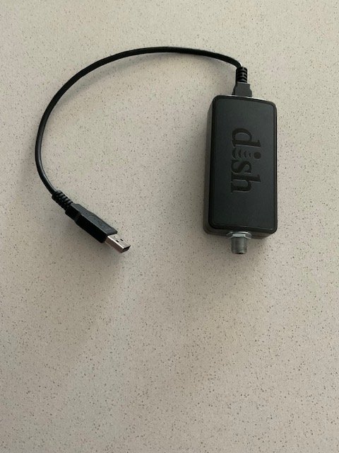

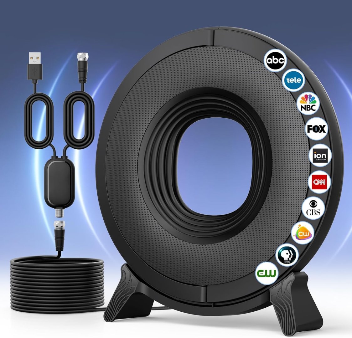

I just purchased a digital HDTV antenna model AN4006-001R. This comes with an amplifier that connects to the antenna's coax. The other end of the amplifier has another coax and a usb. I am trying to connect it to my hopper 3 so I can see the OTA channels on my guide. My problem is if I use the included amplifier, I have an extra usb plug since the dish OTA module also has a usb. I tried to connect it without the amplifier and get no channels when I scan. I also tried to connect the coax end of the amplifier to the dish OTA module and just use the dish OTA module usb. The usb from the booster wasn't plugged into anything.
I installed the new antenna with included amplifier attachment directly to my TV and got a lot of OTA channels.
What am I doing wrong?

I hate to say it but its probably a crappy antenna. I hope you kept the box and receipt. For antenna advice check out Antenna Man in our Social Influencers forums.
It seems to be a good antenna. I got tons of channels when I connected it directly to my TV. I hope to find a way to connect it to my hopper 3.
I'm not sure I understand what you did. Your antenna amplifier needs a usb power source. Either you can plug it into a small power brick like comes with your cellphone, or you can plug it into most television usb ports and get power. The antenna coax must be attached to the DISH OTA module input.
The DISH OTA module must be plugged directly into the DISH receiver usb port.
I agree with above, that's not a good antenna for anything but nearby UHF stations. If you have any VHF stations, you probably won't pick them up well unless you are very close to the station broadcast antenna. But, that's not your immediate issue.

Thank you. I will see if I can plug both USBs into ports. The hopper has 2 usb ports on the back. One is 2.0 and the other is 3.0 I tried plugging them both in, but still got zero on the scans. I don't understand why a bunch of stations are showing if connected to the TV and none if connected to the hopper.
Try plugging in the USB power for the antenna into a separate power source such as a 2 amp cell phone charger.
Just a guess, there could be a chance the hopper does not have enough power on the USB port to power the dongle and antenna. Antenna could be sucking all the power to the point the dongle cannot operate.
Stick a paper clip in the dongle to act as an antenna, and only connect the dongle to the hopper. Depending on the area you may pick up a few channels using this method and this will help you trouble shoot the situation.
Its also possible that the amplifier is introducing too much noise into the signal from the antenna. To be perfectly honest with you the antenna you have is crap, but may work good depending on how close you are to the broadcast towers. Ever since broadcasts went digital, its a known fact that all tuners in TVs and devices such as the Hopper USB dongle have different sensitivity levels when picking up over the air signals.

Jerab, I think you are making it too difficult. Simply plug the amp USB plug from the antenna to the amplifier block and plug this into a wall outlet. Then plug the RF end of your antenna into the Dish OTA Adapter. Finally, connect the other end of the Dish OTA adapter (USB end) into the Hopper.
I would not connect the amp USB end into the Hopper. As others mentioned, the Hopper may not be able to power the antenna. Only the Dish OTA USB adapter should be plugged into the Hopper.
And then, as others mentioned, you need to go into the Settings on your Hopper and setup and scan for OTA channels.

Get you a splitter and plug your antenna into it as a source and then one goes to the TV and one to the DISH ota tuner that hooks into the hopper by usb.

Plug the dish OTA module after the amp. Then plug the the dish OTA module usb into the dish receiver. The dish receiver gets it's ota signal through the usb. Then plug the antenna usb into the tv usb or a usb power supply. If you want to get OTA to your tv too, you must put a splitter between the amp and the dish OTA module. Hope that is as clear as mud, but that is what you have to due, trust me.
