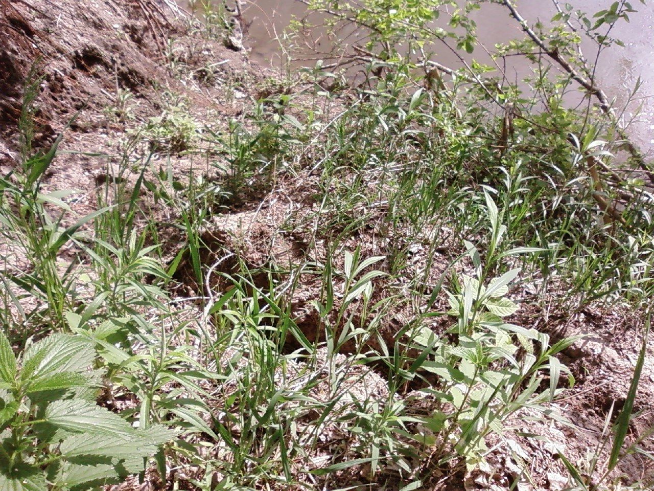

Here is one image from my phone that is the largest I have (583 KB). Odd, the close ups are the largest files. This may seem an odd photo subject, too... A bunch of weeds and some dirt and water? LOL Well, it has a purpose behind it. I was recording evidence of erosion damage along the riverbank near my cabin. This photo was showing how the bank was sloughing off into the river (see the crack in the dirt?).
