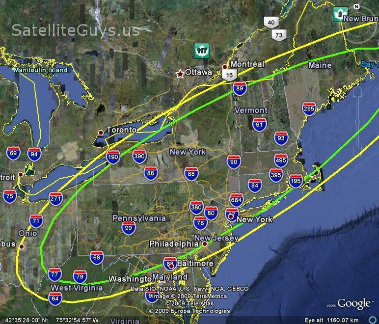

For the past 5 years I've lived approximately 200 miles from Johnstown, PA in an area right on the PA/MD(zip code 21740) border. Over those past 5 years I've had my distant PA locals coming through here on satellite 129 with no problem. Just recently none of the channels came through and gave me error 536 that my locals were interrupted. Upon calling Dish and speaking to an advanced tech he told me that I did not qualify for my PA locals and when he tried to put my Maryland address in the computer, it was telling him I cannot receive them. He also went on to inform me that the FCC controls what zip codes qualify for what locals they can receive. What doesn't make sense to me is why has it been working fine for the past 5 years but just recently (within 6-8 months) have they just gone out. Is this true that the FCC can and will update zip codes that do not qualify for certain locals? I checked the 129 spotbeam via CIEL2_SB26.jpg
?and I'm still in the designated area to receive the locals? I'm stumped and any help would be greatly appreciated as it determines whether or not we stay with Dish or transfer to DirecTV.

I doubt it. My post was assuming that you were getting Pittsburgh locals instead of Johnstown, and that you hadn't "moved" your service address. My best guess now is that since you are on the fringe of the 129 spotbeam, that maybe an obstruction or a slight misalignment of your wing dish is the culprit. Do you recall what your 129 signal levels were prior to these problems? Being on the fringe, it wouldn't take much to affect the signal.
