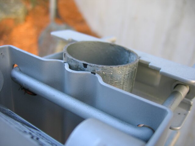

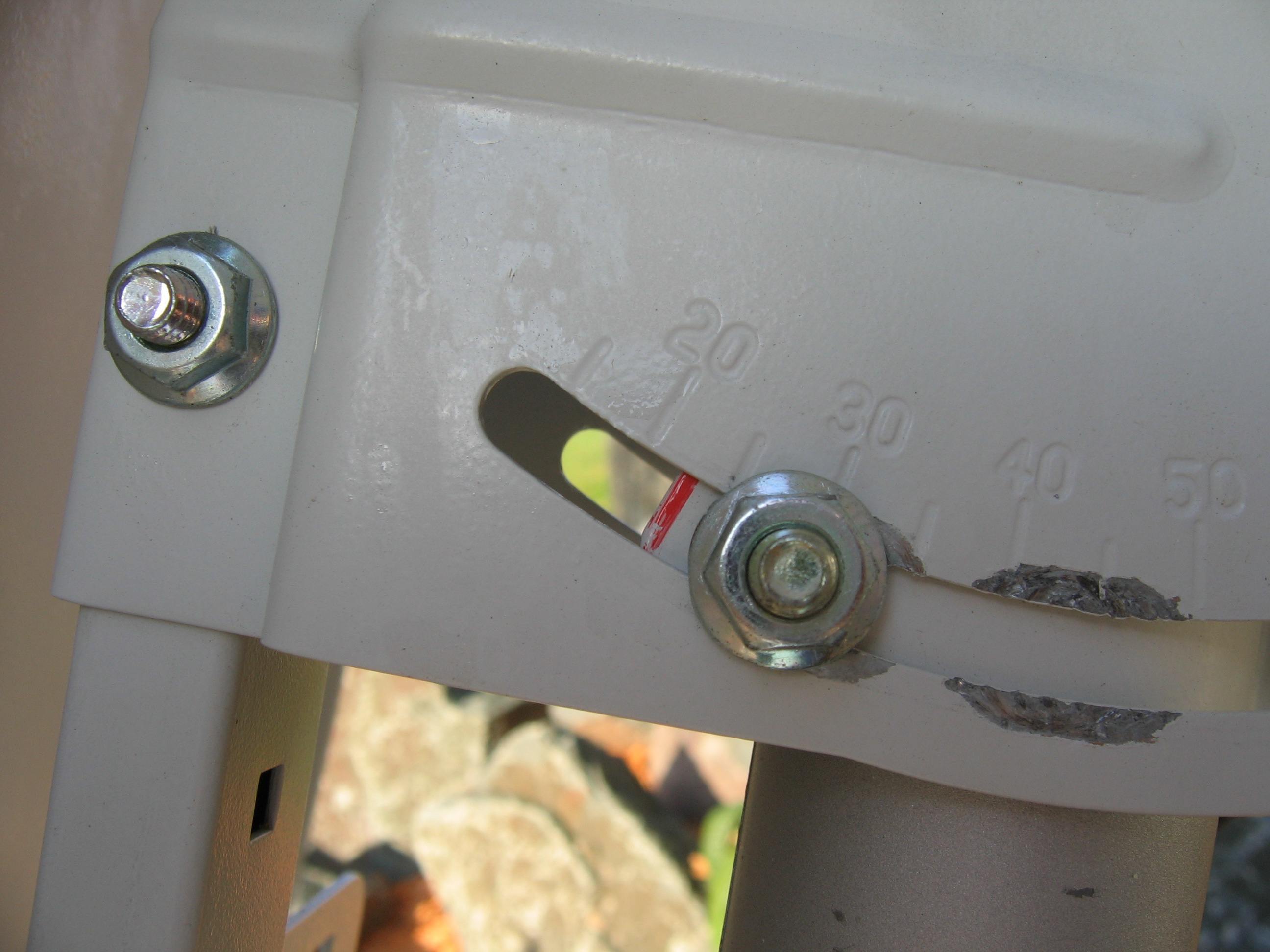

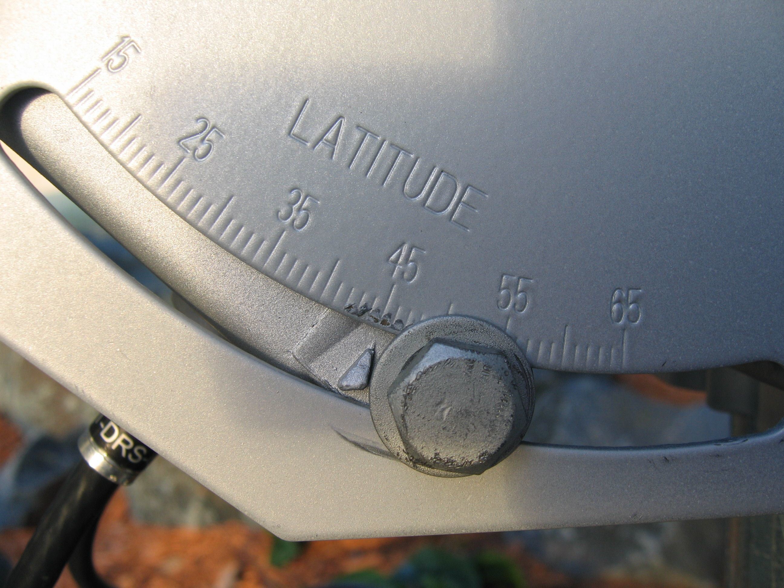

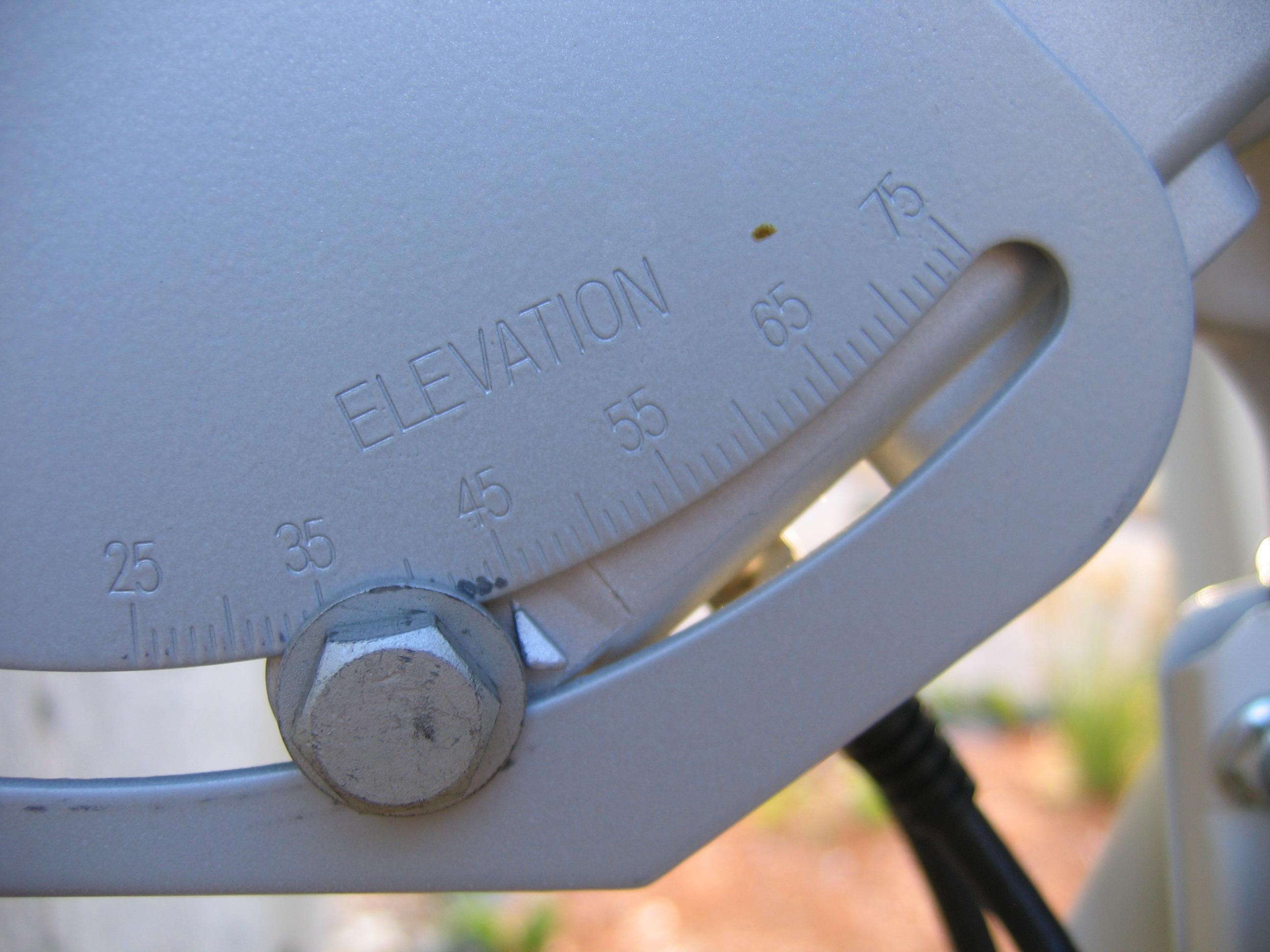

I was wondering if you had a digital camera, if you post a few pictures we may be able to see if there is something not right with the set up, you want to get it as good as you can now as you will need the best signals you can get when the winter comes : )
There are two marks on top of the pole and on the mounting bracket. If I line up those marks, it will be at Amc4. The gap between two marks is about 1/8”.

Ok, I had the receiver outside, next to the dish, hook it up, and check the level and quality before touch the dish.
I noted one of the connection was a little loose, re-tighten it, and at this times, all tp’s of T6 level are above 80% and quality some where around 75% - 90%. So my guess is the connection was loose.
Bring the receiver inside next to TV, the level drop to about 72% - 78% and quality 67% - 78%.
I think, neither the Sun is warming up the dish right now or the length of the cable from the motor to the TV. Have to check it again tonight to find out more.
Remember the angle on the motor should NEVER be changed, it MUST be kept at 45 deg.
Any adjustments are done ONLY on the dish.
