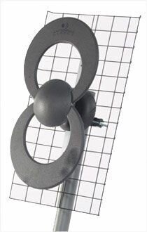

I looked up Castro Valley on antennapoint.com. Although there are literally dozens of broadcast stations within range of you up and down the coast, unless you want to use a rotor or more than one antenna, your best bet is to buy a new ClearStyream2 indoor/outdoor antenna from Antennas Direct.
The ClearStream2 has a range of up to 50 Miles in a small, but powerful 10" x 20" antenna. It has a beam width of 70 degrees, so aiming it at about 260 degrees will bring in the 14 stations within 21 miles easily, including all your networks, only one of which is high VHF 12 (NBC out of San Jose).
Antennas Direct provides customers with a 90-day, no-fault return guarantee on all Antennas Direct antennas and a lifetime warranty against failure, corrosion, defects in materials or workmanship and will completely refund your purchase price, no questions asked, if it does not do the job for you.
