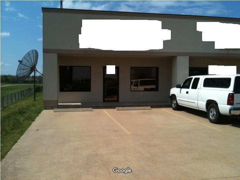

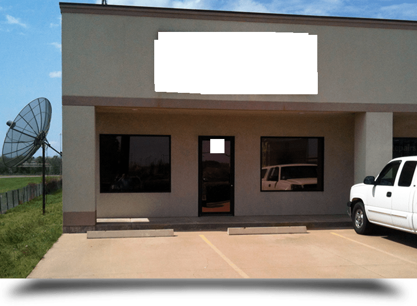

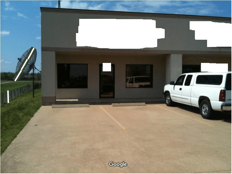

I've been getting that C - Band itch again, I'm hoping to make that dream of me finally owning after all these years a C - Band dish a reality within the next 6 months. Here locally in my area ( Shreveport / Bossier ), there isn't a lot of used dishes that I found so far. I've found 2 thus far. 1 of the used C - Band dishes I found, it looks to be around 7 to 8 ft. The C - Band dish I've attached pic's to, actually belongs to a former local C - Band dish installer / dealer that now sells and installs DIRECTV. I actually talk to this guy a few years ago, and he said he be willing to install a C - Band dish for me, I believe he quote me a price for install, which I'am cool with cause I got absolutely no mechanical skills, plus he is a former C - Band Installer and Dealer so he knows what he is doing
The purpose of this long post is, can anyone guesstimate / estimate the size of this C- Band dish I've included pic's of? This C - Band dish is actually right outside his store. I've not approach him or asked him yet if he would sell me or allow me to have it. I didn't want to throw the fishing line in the water, he bite, and tell me I could get it and I wasn't prepared to take off his hands. From my virgin C - Band eyes, I'm guessing this is a 10 ft. C - Band dish

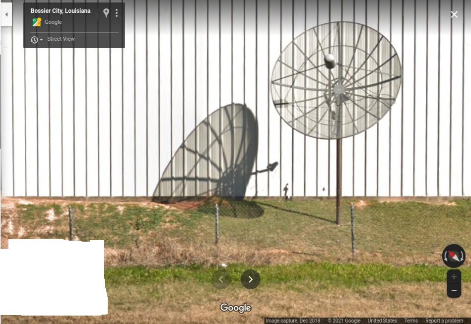

Hard to say the size, as there's nothing really to judge it against. Though IMO, it looks like about an 8 foot dish to me, but it could be a 10. Personally, IF I was paying to have somebody install a dish, with all the new stuff coming up, I wouldn't bother putting one up less than 10 foot minimum. Those extra 2 feet REALLY makes a difference.
It's a ten foot dish. Most 8 footers are 12 segment dishes whereas 10 footers have 16. The feed cover is a good indicator of size also.

It looks like a 10 footer to me judging by the photo ...
Looks like a 7.5' dish to me. All of the 7.5' dishes I've had the feedhorn supports attach to the rim of the dish like that. All of the 10' dishes I've had the supports are inboard of the rim by about 8-10" or so.
