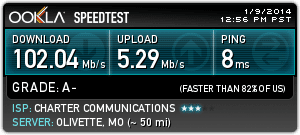

I have 45/6 Internet with 4 Hoppers and 1 Joey Internet connected.
Needless to say, having the Hoppers/Joey connected doesn't slow me down.
Joeys may cause problems
I added WiFi adapters to my 2 Joeys because they were complaining about weak MoCA signals. The WiFi adapters solved the problem, but they do transmit constantly. Even when the Joeys are "off". I have them on their own wireless network so they don't interfere with anything else in my house. I only noticed because I turned my router's activity monitor on and noticed that I was transferring hundreds of GB per month.
My system is running good too with the Hoppers/Joey connected and the kids XBOX One purring away. Wish Charter had faster up speed.
