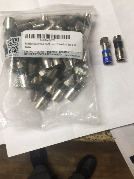

Blue = Digicon DS6-11-05
Black is unmarked, but the bag says Perfect Vision. Now where have I heard that name before.....
:D
Can't upload picture from iPhone. Keep getting "not an image as expected."
Posted from my PC.
