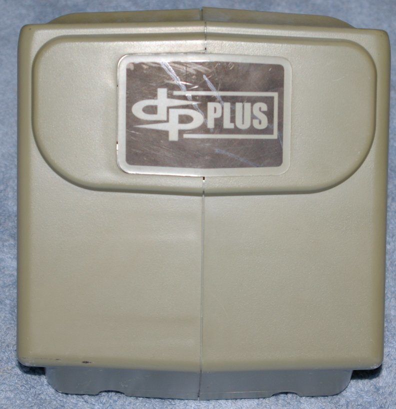

I got the LNB tonight, and though I haven't tested it yet I did want to check again here because it does have the DP PLUS logo on the inside tag/sticker that also has the lot num. and P/N.
On the other side, the outside surface you would see when installed, the logo appears to be only the DP logo, not having the "Plus" addition.
So is this thing a DP or DPPlus? I wanted to ask before connecting it as others have said it's bad to put a DPPlus output into another DPPlus switched unit.

They never made DPP duals or singles so you have the correct LNB.
Ok, so I hooked up the new LNB to the DPP Twin and check switch looks good. Just for reference in case anyone was wondering why I was confused, here is a photo of the LNB:
As you can see it has the regular Dish Pro logo on one side, but the Dish Pro Plus on the other. Anyone know why it would have the Plus logo? As far as others have said, a Dish Pro Plus of this LNB is not supposed to exist. Maybe the logo is just to indicate that it's compatible with DPPlus equipment?
Anyway, thanks for the help.
Huh. That's definitely a dp dual. Seems like the wrong label on the inside above the dual outputs. Now I'm going to pull 2 spares out of my drawers and see what they say.
It's just a labeling mistake. I've seen it before.
I just checked my two spare duals and they have consistent DP labels on both sides.
