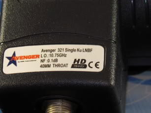

Ive never used Avenger brand lnb's, I have a hard time believing their claims of a 0.1db noise figure. Never the less Im sure it will do.
Anyone else on this forum use that brand and care to chime in?

Well, that's the right kind of LNBF. 10750 LO.
Generally called: Standard
One less thing to bite you in the shorts.
I'm sure it'll work fine, but as mentioned, that 0.1 DB noise figure is marketing hype only.
