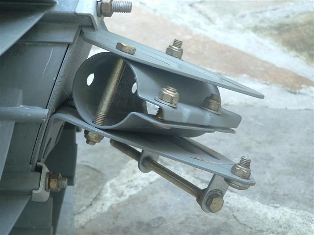

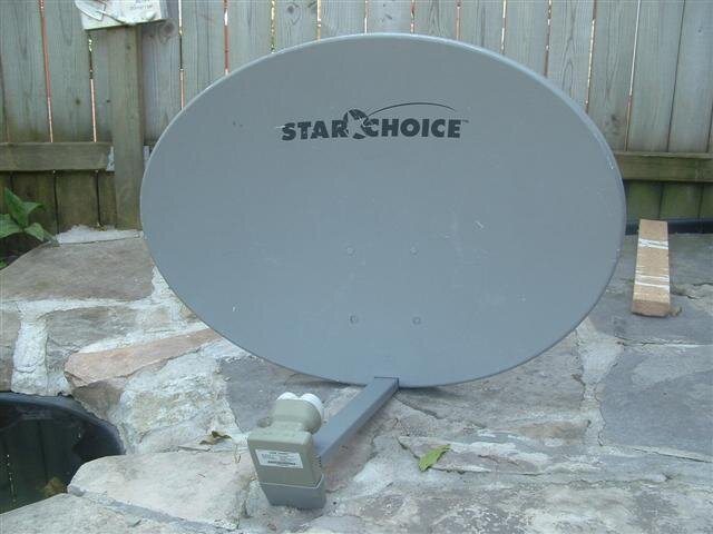

I've got two pictures attached, one of a dish and the other is the back of the dish.. Its a *C one but its that 75-E-2 dish thats way bigger then the smaller elipitical one. Can I put a few more LNB's on there to get more then one AMC Sat?
Also, on the back of that dish take a look at the bracket, what kind of arm does that take? I cant find one anywhere.. It also looks like its got some bolts on the side for extra support? What were these dish commissioned for? *C service up north?

That bracket is a 2" pole mount If I remember right
The screw is the elevation adjuster (god I love those) :)
The 2 bolts on the side are for the elevation to be locked down
